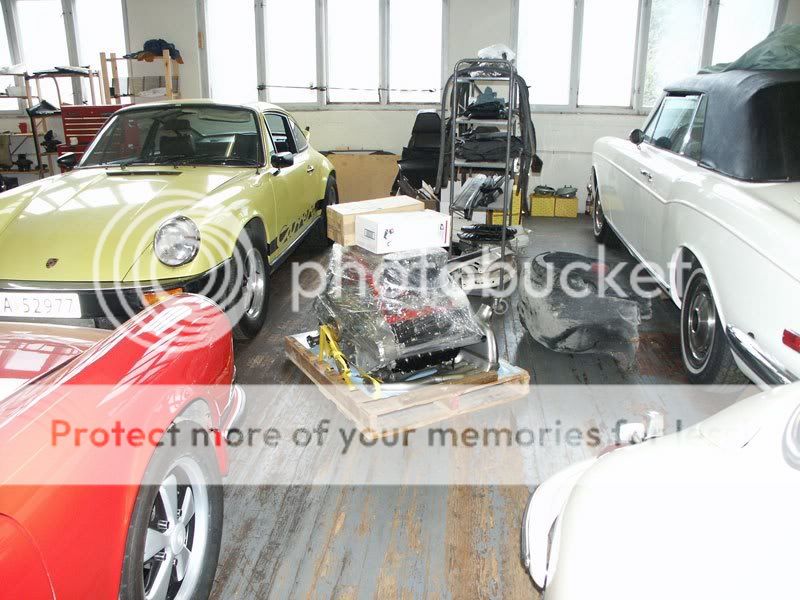

I have this rebuilt carrera RS (style) engine, it was done professionally on the west coast, I have had the engine in my carrera 74 for a long week now. I actually took some time off to put the car in operations but it has been a tought week.
![]() It has been anything but smooth, having spent many hours reading up and down MFI threads I think I have a decent overview ( I also have a 69E and a 70S so I am not that unfamiliar to the system/engine) I got the engine minus alternator and oil cooler but else it was completely done, rebuilt/redone MFI etc. My approach was too follow the CMA, throttle sync and correlation seem good. The long pull rod from the bracket must have been too tight, the throttle butterflies would not rest so I took it off and twisted it until it let them rest at idle. ![]() Ignition was tested and set static at 0, MFI pump was primed with 3 dl oil, quite a few squirts down the throttle bores and engine came alive last friday, it ran horribly, no way to get a throttle and no way to get the strobo lamp on it to verify, there was popping and backfiring and whatever I did the outcome was stalled engine. Top of this I had to keep revs under 3-4000, thats what I thought at least. The engine would come on quite ok up around and above 3000 rpm but I dont want to run it up with all these other uncertain matters. ![]() The only way to check whats happening are the plugs, they are getting black, I suppose we are getting way too much gas. ![]() I have spent some 30 hours on it since friday and gone through the CMA. Ignition: I tried a std CDI system, same problems ( I have MSD that worked great on the old engine ), I tried the original 74 distributor with vacuum (wrong curve but I was only setting 0 and reving up to 25-3500), same burping and backfiring. So, we are saturday, sunday, monday and half tuesday into the car, its not getting any better. After lunch I used my hot gun to really heat the thermostat once, tried more. Cleaned the plugs again and started it, still burping and backfiring, I have a colleague help me out holding the throttle (though it is almost impossible to find a steady running position) and I more or less veriifed the ignition dynamically to be around 0 degrees 800-1200 with vacuum (impossible to get steady running). Took out and cleaned plugs, took distributor apart and set .35 mm opening (it was not far off), checked moving parts, installed. Heated the thermostat... checked the main rack, moves fine, checked the fuel pump timing, dead on. Due to the mixture being way too rich I decided to adjust the load and idle mixuters, leaned the out both. Yes, not the CMA way but what can you do when all else have been gone through? Car started a little nicer and I kept it running and it was actually getting better now. Took it outside to hook up the LM-2 as running it with the exhaust fan/extractor mess up the reading from the LM2. ![]() I was getting AFR around 20-24 on the idle and the load (if we can call it that, ca 2500 rpm) gave me AFR around 14-15, both are jumping more than I would expect but stable enough to work out from. Its getting dark so I have to get onto that tomorrow... Having tried parrallel ignition systems I suppose the problem was not there, my conclusion so far it must have been the MFI pump. Have a few questions to the experts; Anyone have had these problems with rebuilt pumps? Since I have messed a little with the mixtures, would anyone have some AFR values for idle and part load? (I can measure lambda so perhaps I can convert from that..)

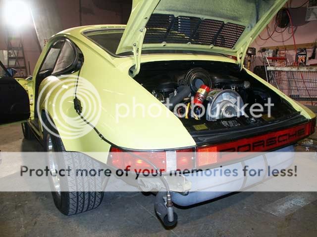

Seems like I have the ignition in place now but I am not ready to take it to 6000 rpm to verify for a while. I had some problems getting the tach adapter to work as well, my LM2 reported 10350 rpm at idle so I know for sure we have mupltiple sparks ![]() I forgot to mention but I also have changed the first oil (to Brad Penn 20-50W "green oil") now, the old oil had about 20-30 minutes on it and should have cleaned out the engine by now. It was slight dark colored,I used a light colored 10-40 performance oil for the initial startup to have a free flowing oil, it is also easier to analyze it after you drain it.

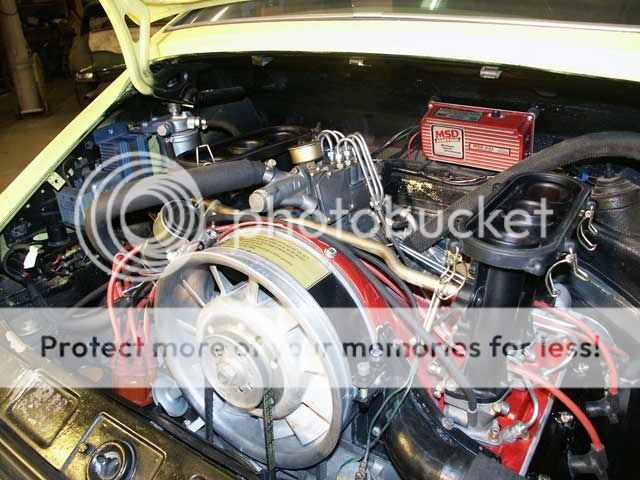

I suspect there is some easy solution. First, you can test the distributor off the engine and confirm the advance curve from static and idle to 6000 rpm (3000 rpm distributor). This will let you set the timing statically with confidence of very close timing at 6000 rpm. You can confirm the 2.7RS advance curve. You have checked pump timing. Good. I recommend you force the thermostat to ‘OFF’. Henry sells a mechanical device that replaces the thermostat. I suspect he will lend you one for your start-up. This takes the thermostat out of the equation. Henry does good work. I want you to confirm the valve adjustment, cam timing, MFI pump model (and research any service or modifications) and the intake components (throttle bodies and stacks size and fit). Be very careful adjusting the MFI pump. Keep track of your changes. Every time, you want to be able to return to prior setting. Clearly you are running too rich. As you lean the system, you want it appropriate for the range of operation of your 2.7RS; starting, idle, light throttle, full throttle, peak rpm and more. Proceed deliberately and carefully. You will have a lot of help on the Forum. Best, Grady

Two numbers from your posts stand out to me. First, the zero advance timing at idle. Seems to me somewhere around ten degrees initial and 30-32 total at 6,000 rpm is close to spec. I think your initial advance, or lack thereof, could be contributing to the poor running.
The other number is that idle AFR of 20-24:1. This needs to be 12-13:1; it is far too lean to run properly. You need to significantly fatten up that idle mix. O.k., maybe there are three numbers we should talk about. Your part load mix is too lean as well, but not nearly as bad as the idle. It, too, should be somewhere in the 12-13:1 range. About half a dozen clicks on the main rack should be close; remember, left is rich on the main rack. This will affect the idle, but not enough to move it 8-10 points. You will have to adjust the idle mixture screw as well. Remember, this one is opposite from the main rack - right is rich. So, in essence, fatten up the mix and advance the timing. Retarded timing will make it sputter and pop, reluctant to take the throttle. So will a lean condition. You have both.

I am trying to get the afr on idle down to around stoich mixture, for the part load I am targeting to 13.5-14. The correct ignition on this engine is actually 0 degrees with vacuum at 950 rpm, it beats me but thats the way it is. I will take the car outside later today and run more tests with the LM2, ... ie if it starts.

Ummm, with a rs curved distributor, there is no vaccuum advance. You set it to 0 with the engine off and at TDC on #1. This should get you very close at 6000 rpm and you can tweak from there if needed.

Another dumb question, are your plug wires going to the correct places?
Are you running pertronix? If you are running pertronix with the S rotor, you need to shave the rotor or else it rubs on the pertronix pickup and the car runs really poorly.

I did try to put a pertronix breaker but the axle in the reground unit seem to small, breaker fit tight in my 74 dizzy but on the rebuilt dizzy its loose. I put the breaker points at a tight .35 mm and that wont be too far off. Dwell and timing will be fine tuned when i have some hours on the engine. Plug cables are correct, the engine is very lively on half open throttle but the low end is a rat. It does however start and run a poor idle now, i also took apart the thermostat and it was of course clean as expected, have not gotten around to check/measure the thermostat more, it seems to work though. I think the carrera rs was delivered with vacuum, my engine has it and a few engine pix on the internet shows the same. ![]() Peter, at this point I decided to take a steep learning curve on the MFI rather than relying on providers, in the future I will spend my money somewhat different.

Disconnect your vaccum advance and see how it runs. The S and RS were pure mechanical advance. If you have a vac advance dist recurved, it is now probably also pure mech with the vac pot still on it - like mine.
Give it a try or call Henry for confirmation on this.

Don't believe the idle readings. The LM-1 with the sensor at the tip of the tailpipe is notorious for giving a false lean reading due to reversion.
If you can, weld an o2 sensor bung up where the three pipes meet, and install the wideband 02 there to get an accurate reading.
'69 911E coupe' RSR clone-in-progress (retired 911-Spec racer) '72 911T Targa MFI 2.4E spec(Formerly "Scruffy") 2004 GT3 |

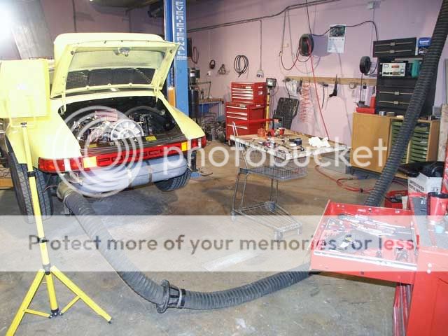

Maybe I should measure the car indoor with the Nedermann exhaust extractor running then, it sucks bigtime so it would work against reversion... I have SSI headers/exchangers and I was thinking about welding a bung in the muffler an inch from where it hooks up with the ssi, prefer welding in mild steel to stainless.
