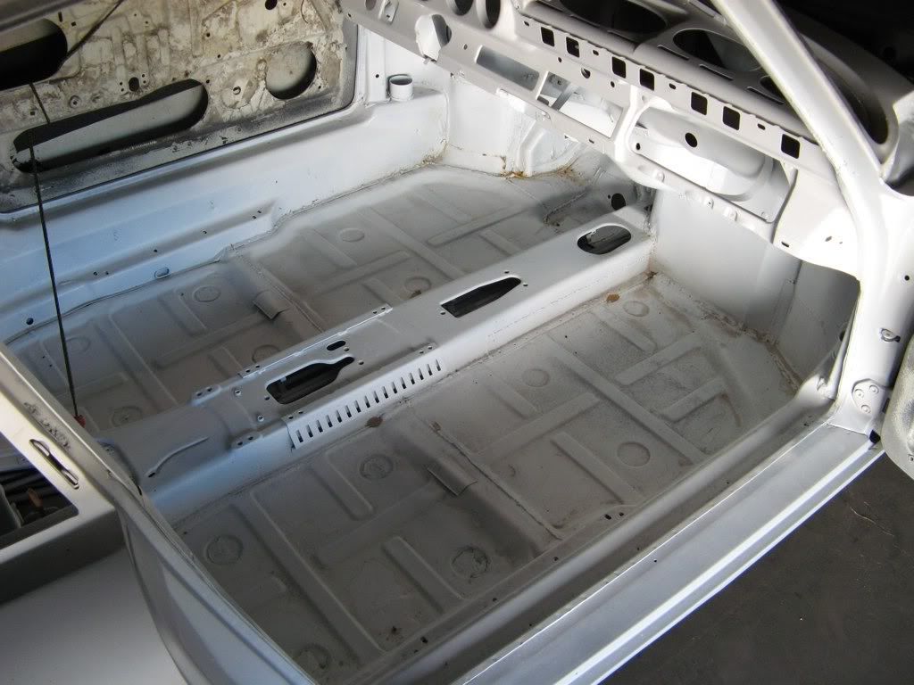

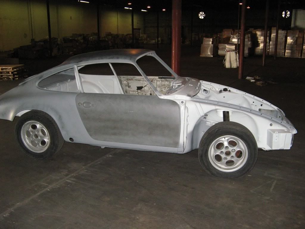

take a 71 tub which has already been stripped and it basically perfect condition, cut out a new pan for a later model 6 speed transaxle and 993 tt engine and full coilover all the way around
or
"backdate" a 1990 911 964 tub which already has the correct engine and tranny mounting point and suspension mounting points?
option 1:
option 2:

many will
the 964 tub is much stiffer than the early one yet weighs only about 40 lbs. more
it is already fitter for coil overs and you can run wider wheels/tires with no mods needed; it is already rustproofed too - moreover, if you don't like the blobby look, you can backdate it to look like an early car
if the '71 is an E or an S tub, then it is worth money
