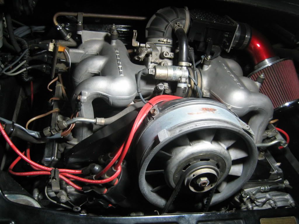

Posts: 210
I decided to make my own intake for my 3.2 using part of an AEM intake for another car. It still has the breather attached to the bottom of the elbow. The only concern seems to be if a large amount of water entered, so if you use the car in the rain, fab up a shield to go over the top of it.
[IMG][/IMG]

Wil, as best I can tell from your picture it seems you simply cut off the top of the air filter box. Is that right?
Is the filter then fully exposed (but probably about an inch or two in from the top of the lid)?

Swoboda....yes to all questions....pretty simple. Looking at the picture I posted....the flat plane across the face of the open area is indeed the fliter, but it's hard to make out from that angle of the photo.
