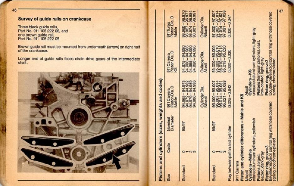

What is the difference between the brown and black chain rails / ramps / guides?
Just curious and can't seem to find the answer. What is the difference between the brown and black timing chain rails / ramps / guides?
EDIT: Hang on, I think I see now, the black rails appear slightly "taller" than the brown rails.
It appears that the PO replaced all the rails with the brown version.
Anybody know the torque value for the ramp bolts?
EDIT: Found it; inner chain ramp bolt torque value is 18.4 ft-lbs.
Anybody have a good picture showing the correct ramp orientation?

black tall, brown short. brown goes in the right lower engine case. long ends point to the closest sprocket, so in the case, long ends inward, in the chain housings, outward.

Thanks JW! Actually, I just looked again and 5 are brown, one is black (the inner bottom right) AND the long ends were pointing outwards on the inner case rails! Talk about assbackwards!

Is there a "set in stone" color and position for these ? I have 2 browns on the inner passenger bank, and one brown inner drivers side. The rest are black.
As far as i can tell, this motor has never been apart.

Hi Tomeric..you have to have all black and only one brown.....
Hi...Tori here is the diagram how it is done correctly.. no any other-way.....

Thanks Ivan, that clears it all up.
Wonder why these motors are getting put together with the wrong parts ? Weather it be from the factory or independent repair shop.
