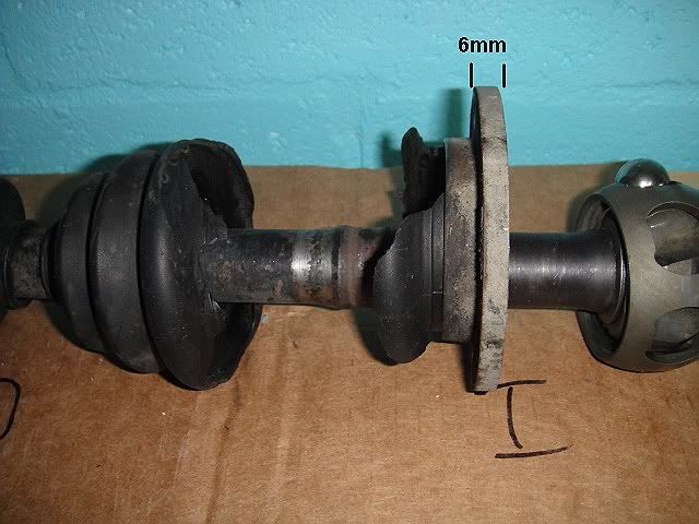

I can post pics tomorrow.
The flanges which are integral to the boots appear to be steel. The diameter matches the CV joint, so I'm assuming 100mm. Thickness is appx. 5mm.
The recess appears to be deep enough to contain the gasket.
I'll have to measure the bolts when I return to the shop tomorrow.
No Schnorr washers, or moon clips, just flat washers (only on tranny side...no washers on wheel side). Axles have been in place a long time. I haven't touched them since I purchased the car (2006), and only God knows how long they've been neglected.

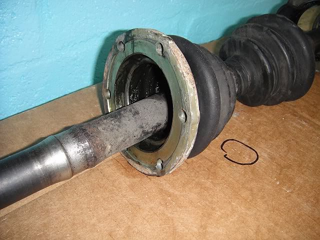

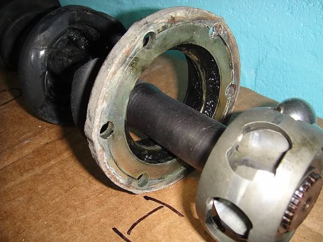

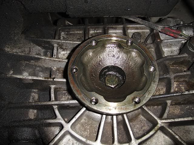

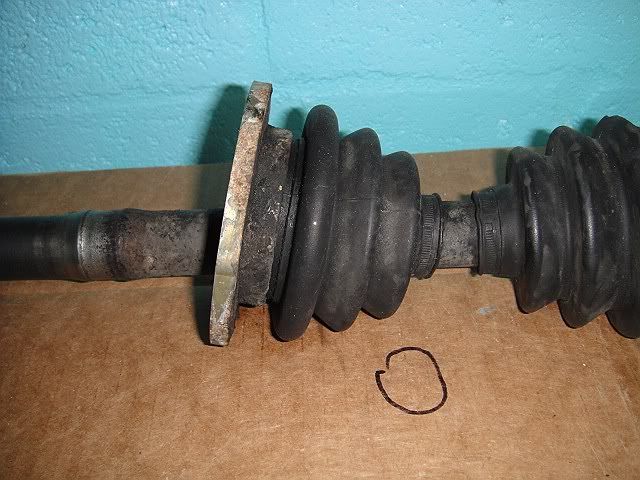

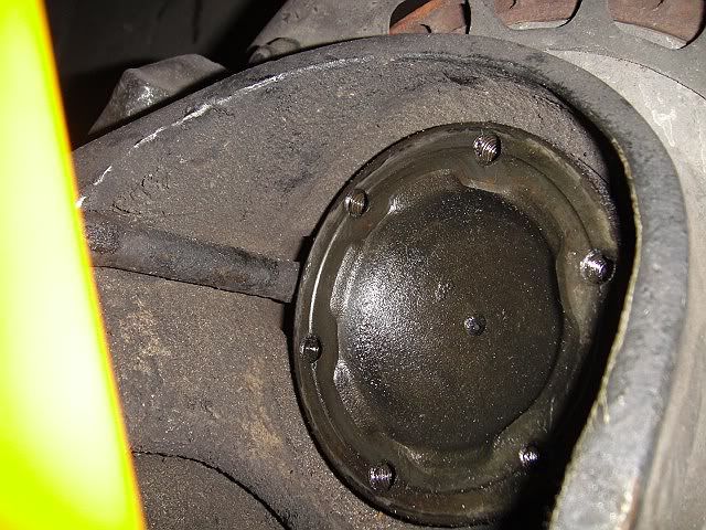

OK...here are the pics:
Output shaft showing recess for gasket...
Wheel-side (stub axle?) showing recess for gasket...
CV boot/flange unit showing recess for gasket...
Wheel side boot/flange...
Torn/separated CV boot/flange indicating thickness of flange...

Old 01-23-2011, 04:00 PM
Danny_Ocean's Avatar
Join Date: Aug 2006
Location: SoFLA
Posts: 5,536
Bolts are M8x50
