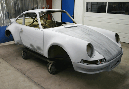

Updated photo's of the body... Having had the car walnut blasted, the entire car is almost all lined up and ready to paint....
http://forums.pelicanparts.com/uploa...1314068462.jpg
http://forums.pelicanparts.com/uploa...1314068474.jpg
http://forums.pelicanparts.com/uploa...1314068483.jpg

will hung 08-24-2011 04:51 AM
Out of curiosity, why is the engine cover grill filled? Awesome project.
JEM911 08-24-2011 02:20 PM
The probably best explanation is on the Patrick Motorsports website:
Patrick Motorsports - 1974 Carrera RSR Twin Turbo
Essentially because we have to fit the 993TT engine (including inter-coolers), you need to fabricate a 'new' deck-lid with clearance.
will hung 08-25-2011 05:05 AM
I see. So it'll kind of be like a whale-ducktail. They flatten the top to clearance the intercooler. I figured it had something to do with the intercoolers, but was just curious. I wasn't sure if they'd use the OEM routing of the intercooler, or if they'd take Ruf's routing and lay the intercoolers on either side of the engine inside of the engine compartment. So I see that they'll be using the OEM routing.
