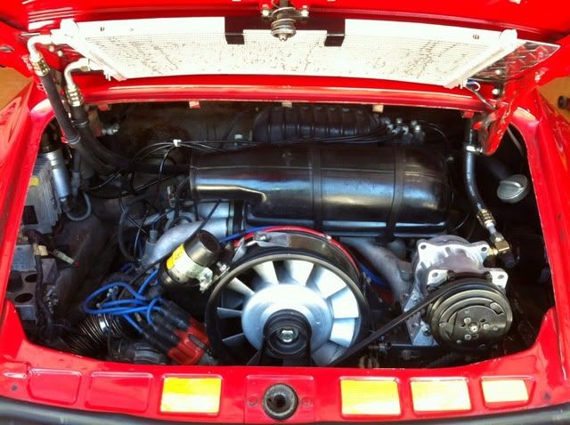

Look closely on my picture below of the same rear PFC you are using and notice at the out-side edges I was using clear plastic in testing to fully seal any air inlet and PFC air leaks to force ALL INCOMING AIR THROUGH THE PFC so none could escape around it. There is further soft rubber insulation sealing you can not see that fully seals the PFC

Look closely on my picture of the same rear PFC you are using and notice at the out-side edges I was using clear plastic in testing to fully seal any air inlet and PFC air leaks to force ALL INCOMING AIR THROUGH THE PFC so none could escape around it.
Some of the problems with this pfc are
#one 5-6 or so rows of micro-channel tubes below the deck lid intake air opening doing nothing but receiving high radiant engine extra heat instead of getting rid of dumping part of the PFC heat defeating their purpose, because this PFC is way too long for the deck lid air intake hole in one of its dimensions!
#Two a further waste of approximately 20-25 % cubic feet side width other dimension is not long enough for the PFC width of the deck lid air opening; "THAT FURTHER DEFEATS the Porsche early model 911 well known Porsche Factory body design flaw of not having enough cubic feet of room in the first place for the A/C condenser!
#Three this PFC is only an "early type PFC micro-channel technology & ONLY A single pass PFC";
However any 911 rear deck lid PFC even this one is at least better than any older 911 technology condenser therefore it is an improvement (smile)
This ACKITS.COM PFC might work ok for someone who lives in lower ambient temps and/or on a tight budget looking for an inexpensive PFC a/c solution
Oh by the way the black horizontal mark above the black hoses is compressor oil and refridgernt leak caused by my prior a/c compressor before I replaced my old one with a new one, this is a tell tale SIGN mark if you see one similar in this area on your deck lid its time for you to think about getting a new compressor

What is the purpose of the wiring I see above the right hinge area..?

Thats the wiring for the (gasp!) cyclop third brake light above the turbo tail. Trust me, the turbo tail is the next thing to go!!
I agree, it could be a better fit. However, I don't believe the few rows that are not in the direct airflow are subject to radiant engine heat. The whole ingine compartment will be a slight negative pressure with the engine running as the engine fan is drawing all the air and pushing it underneath the vehicle. At worse its creating air turbulence for these few rows which will still remove some heat from it. I don't see engine heat radiating against the airflow.
Again, I agree, could be a better fit. One side will always fall short of the decklid opening due to the need of space for the hose connections, but the overall width should be expanded to cover as much of the decklid opening as possible. If you really wanted to do it right, design a decklid that has a bigger opening to accomodate a bigger condenser. Modifiy a fiberglass decklid to accomodate a bigger condenser and market that as part of a condenser package. If it could be done tastefully, and incorporate say, a ducktail, I would consider that long before I'd consider sticking addition condensers in the wheelwells. My car has a turbo tail (yuck) that I could easily add more condenser to in series. What prevents me from doing this is the turbo tail will sooner or later (hopefully sooner) go away and I don't want the additional weight or hoses/fittings in the system.
My humble opinions.
