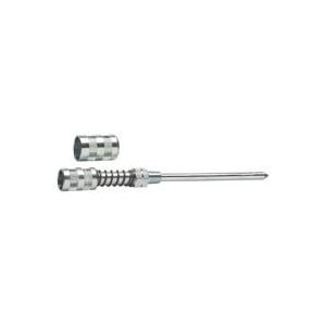

For you guys with rear ER polybronze springplate bushings - what do you use to grease them? I cannot get the tip of the grease gun into the narrow space to grease them.

http://www.amazon.com/Plews-05-025-Needle-Grease-Adapter/dp/B000CCIM1A
I got this one handed grease gun at Harbor Freight Tool for about $8 on sale and the adjustable angle tip at the same place for $3.
Pull back a ring on the tip and it pivots around 360 degrees to change it's angle where it will lock in place when releasing the ring and it will fit the grease fittings on front and rear ER polybronze bushings easily.
ER says to jack the car up to take the weight off the control arm or spring plate bushings so grease flows all the way around them top to bottom while greasing them every 3000 miles. Makes sense.
