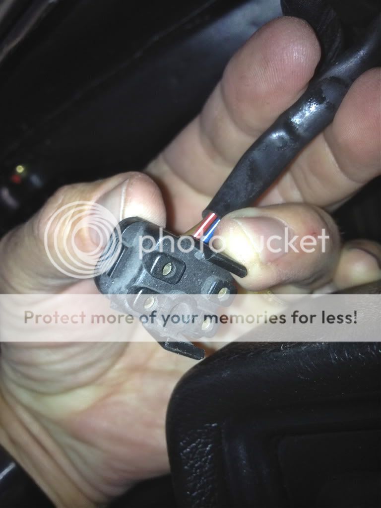

Everything I know about electrical I learned when I was two after biting through an electrical cord that was plugged in. My hair still sticks up. Needless to say the trauma has caused me to avoid electrical projects ever since so my knowledge is limited at best. I removed my stereo head unit yesterday and covered the hole with the factory block off plate. It went really smooth but I noticed this hanging down under the dash. Does anyone know what it connects to? My first impression is that it was part of the original stereo wiring.

Looks a lot like the fresh air blower motor connector, but it's been a while since i looked at it.

What color wires are attached to the connector?

Blue/white stripe, red/white stripe, blue, brown.

Looks like it connects to the firewall and goes to the fresh air blower. Does the other end connect to the in dash heater control panel?

That would be the fresh air blower that loves to smoke? Be sure the blower is off, plug it in, and be aware when you test it that the PO may have unplugged it for a reason.

That certainly does not look like a stereo connector. Looking at the factory manual wiring diagrams that connector is for the "Inside Temperature Sensor Blower", Which according to the block is both a temperature sensor and a blower motor in one. This also fits with the description for the fuse you indicated.

This is the connector for your cabin heat sensor located behind the dash to the right of the steering wheel.

Here's what I think.
Your recent picture says it all........
Your two wire connection to the cabin temp sensor confirms that you do not have Auto Heat.
Therefore, the connector in question, according to the color code,
is a factory pre-wired Auto Heat connector which is not in use.

That makes sense. I was beginning to think by the looks of connection points on the plug that it was never plugged into anything. Thanks for sharing your knowledge.
