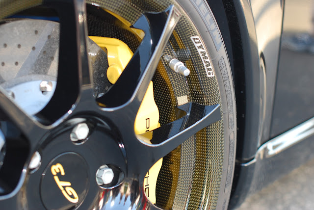

HarryD's Avatar
Join Date: May 2002
Location: Portland, Oregon
Posts: 12,678
Originally Posted by tshort View Post
This is actually the right question to be asking. What does it matter, and what can anyone do about it?
Easiest thing to do is to make sure your wheels are as light as possible. The difference between a Fuchs forged alloy wheel and just about any other standard cast wheel is significant - and this translates into more unsprung mass. Drilling your brake rotors could also help, although I think this is usually done to improve heat dispersal. The Jag's inboard brake rotors in effect took all the rotor mass and turned it into sprung weight (well, at least a portion of it anyways). Yes, you can feel the difference in handling when there is less unsprung weight. It's actually pretty amazing.
Less unsprung weight will show up in a few ways:
1. the suspension's ability to absorb bumps and settle down quickly is reduced the more unsprung weight there is. this means that if the car suspension has to deal with a bump and is unsettled during a corner entry, or mid corner, it won't be as compliant and you will not be able to go as fast as you could with more compliant suspension.
2. less unsprung weight = quicker direction change. The greater the rotating mass of a wheel the greater its gyroscopic effect, which is what keeps it wanting to continue going in a straight line. Reducing the rotating mass makes it easier to turn, making for 'better handling', lighter steering, quicker direction changes.
There are probably some other variables that unsprung weight affects as well like how hard your suspension has to work, and therefore how long it will last. And how much heat it will generate, which effects how well it works. These are secondary, imho.
So-called 'mag' wheels were a big deal back in the day because they were made of magnesium alloy which was significantly lighter than the then-standard steel wheels. I don't know if carbon fiber is being used for car wheels - it is for motorcycles. It takes unsprung weight to the next level.
You mean something like this?
As seen here: danumatic: Dymag carbon fiber wheels
Harry

Old 04-02-2012, 08:52 PM
Formerly known as Syzygy
Canada Kev's Avatar
Location: Calgary, AB
Posts: 4,420
I read that some auto racing groups had outlawed or frowned upon the use of carbon fibre wheels. I guess when they get damaged, they fracture badly it's often with quite catastrophic results. Or maybe I misunderstood.
I know they are used in motorcycles regularly. In this, having less unsprung weight is quite important. A race bike weight of 350 lbs isn't abnormal, so even saving a few ounces makes a difference in top levels of racing.
Kevin

Posts: 19,644
There are aftermarket full carbon fiber motorcycle wheels (not just rims, they are monoblock, hollow spoke). I think they are made in South Africa. There was an article in Sport Rider a while back.
BTW, the Formula SAE team used carbon fiber wheels for a bit. They ended up breaking and they are now back to minilites.
