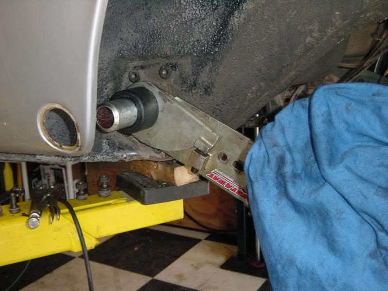

I began a new project this weekend; I'm modifying my shortened 911SC spring plates to have a screw adjustor like Sway Away no longer makes. I'm also beginning a four wheel alignment and corner balance using the corner scales and simple string alignment aid I made and will be marketing shortly; more on that later.
I first removed rear shocks and installed my height adjusting rods:
I also disconnected my front sway bar drop links and connected them to the brackets on my inner wheel well:
I adjusted rear ride height while supporting front cross member to avoid corner weight bias:

I installed and adjusted my car using these just fine. I need to make one more iteration in ride height that is beyond the range of adjustment but haven't gotten there yet.

BTW how are you using the height adjust rods
Old 04-23-2014, 09:29 PM
1QuickS's Avatar
Join Date: Feb 2008
Posts: 1,438
I used the rigid links to adjust ride height and alignment and then installed t-bars and adjusted to just take the load ff the links.
I made the links for use in assembly and other tasks during my build as a convenience to hold the car at ride height while working on it...this is primarily why I had the links in the first place.
