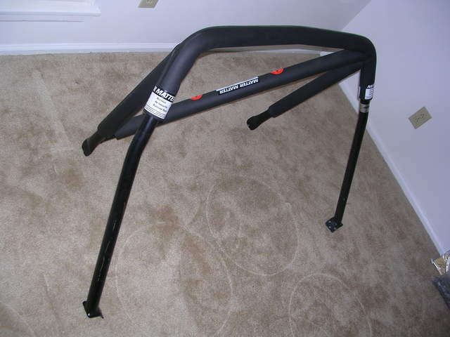

I could be wrong, but my research found that no sanctioning body will allow aluminum roll bars on the track. A vintage car with one could be grandfathered for historic events, however.

I found an example of a Matter roll bar from way back in 2006, however from the post it's unclear to me if it's aluminum.
Matter Roll Bar...NOS
Originally Posted by LARennsport View Post
Very Rare....and...Never installed...in excellent shape. It bolts to rear seat belt mounts and then has plates for the front portion of the hoop which can be welded or bolted. I bought for 964, but understand that this will fit 964/993 AND will also fit earlier cars (Carrera) w/slight mods to front hoop mounting plates. I'm only selling as I found an aluminum cage instead...love this piece though. Expensive, but worth having Matter quality and exclusivity...Matter is the German company that built all the OE roll bars/cages for Porsche Motorsports up until a few years ago...they are now no longer in business so next to impossible to find "new" Matter bars...if you are just looking for a roll hoop...go buy a DAS or Autopower...if you are looking for unique piece w/great Porsche Motorsports history this is for you. Serious Offers being entertained. Shipping from 91604....

Rich is correct,the original 964 Cup cars in Europe were all equipped with Matter aluminum rollbars/cages ... friend of mine in Montreal has one for sale,still has the certification stickers and OEM padding on it !
Cheers
Phil
I'd be interested in hearing from someone how the certification standards have changed over the years.
