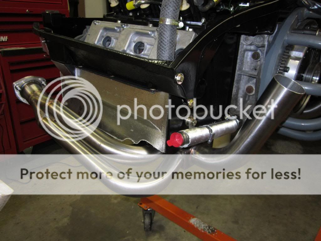

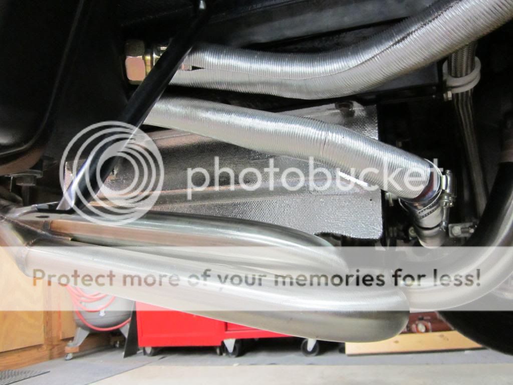

Gordo,
glad to help with the B&B oil pipe. I think the difference in fit may be the hard line from side of case out to where the fabricated line attaches (flywheel end). Mine has slight angle back and up to provide extra clearance AND it also has a bracket to support the end where the fabbed oil pipe connects (critical that you have this support according to Dr. Timmins, and I agree with him)....lots of vibration.
[IMG][/IMG]
and here...
[IMG][/IMG]
