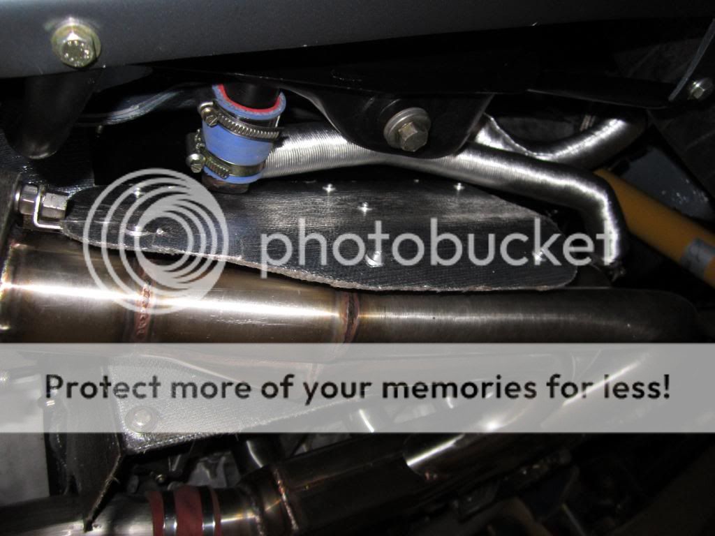

Old 06-16-2014, 09:02 PM
Join Date: Jan 2005
Location: SC
Posts: 212
here's what I did with mine...
[IMG][/IMG]
[IMG][/IMG]
I figured that the Oil Tank would appreciate a little insulation from the heat as well.

Posts: 7,125
Nicely done PDT, great fabrication skills. I am embarrassed to show a picture of mine. It looks like you are using the B&B 'p trap' ( as some have called it)?
