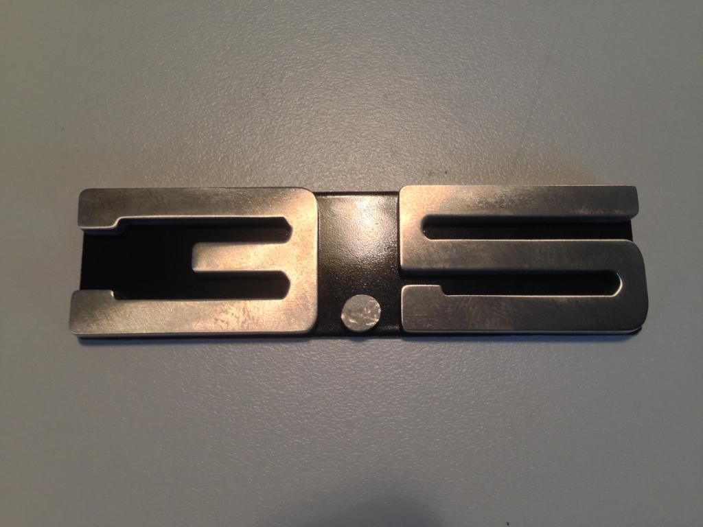

Rebadge.com 09-15-2014 06:53 PM
Hi guys. Here's a quick shot of a 3.5 we did for Otto. The designation isn't touched; he requested bare metal so he can color match other trim.
I will have more pictures up soon. Thanks!
http://i36.photobucket.com/albums/e3...psamescrkl.jpg
Arne2 09-15-2014 08:27 PM
Not bad. Compared to my 3.2 emblem from the former supplier, I think the verticals need to be a bit thicker, as indicated by the red lines. The verticals should be the same width as the curl on the lower bit of the '5' or the upper and lower of the '3'.
Just my opinion. Once on the car, that's going to look pretty good as it is there.
http://forums.pelicanparts.com/uploa...1410838043.jpg
Rebadge.com 09-17-2014 05:16 AM
Thanks Arne, I'll update it immediately and get all the dimensions locked down soon. Once I have all the proper dimensions for each number, it becomes a very easy drop and replace system, design-wise.
