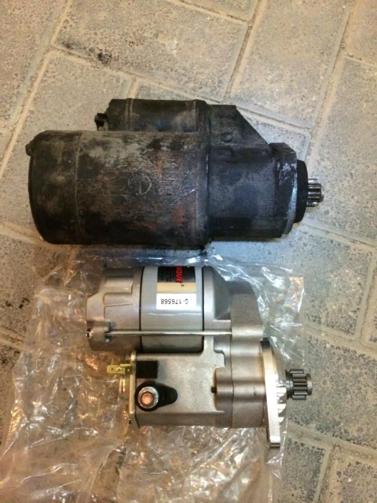

Well, the car won't start again.. the starter seems to get heavier.. Tried flipping the green and violet but no difference..

The adventure continues! After passing the wire through to the engine (thanks Dennis!), I tried removing the starter nut and it came clean off! It seems my starter has rusted through.. thankfully I've already placed an order for a new starter. Everything will be on pause I tell I receive my package from our host

Well, you have definitely found the starter issue!!!

Well, it took this long for me to get my new starter and other trinkets to get the job done.
Here is my old starter showing the damage
Original starter vs new high torque starter
After all said and done (plus 4 hours)

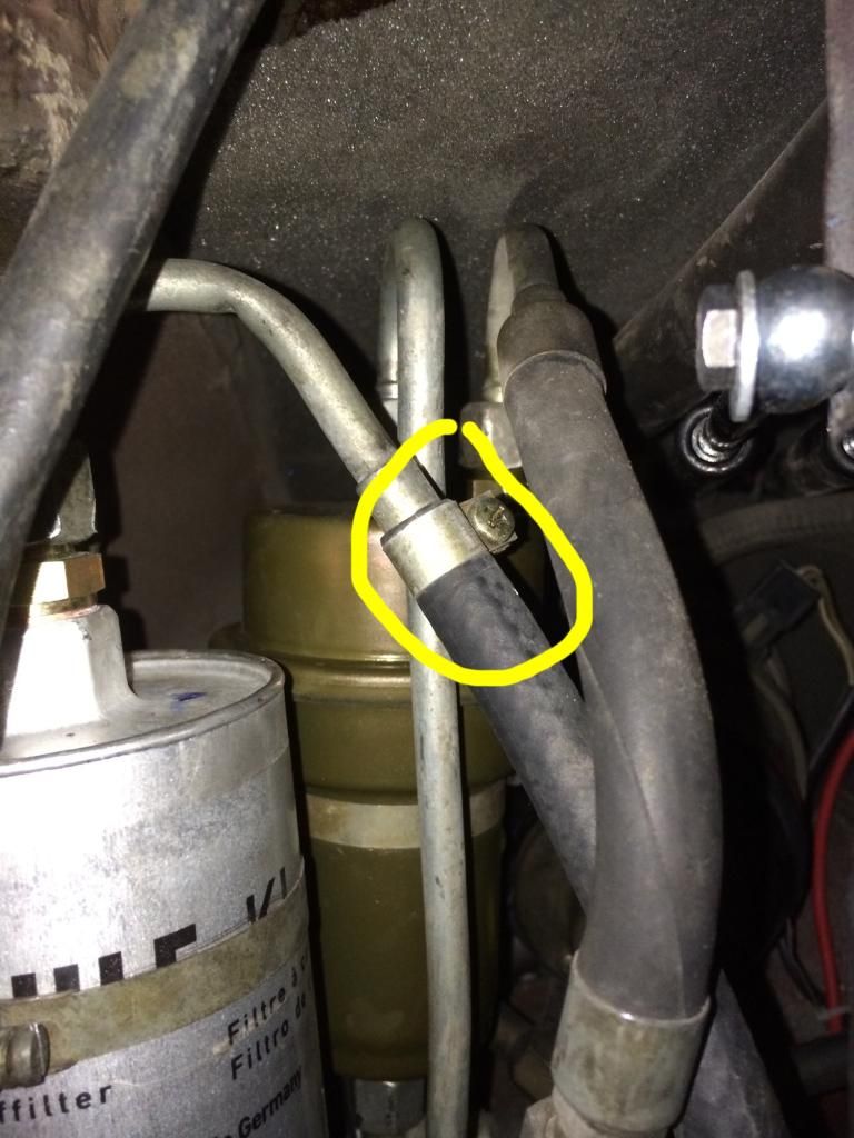

I had also installed a new accumulator and filter, so I turned the key on to start the fuel pump and not the engine, and noticed a little burst of fuel which then stopped. Noticed that this hose would spray fuel if I pushed it. Anyone know the best way to fix it? When the car running it doesn't leak.
