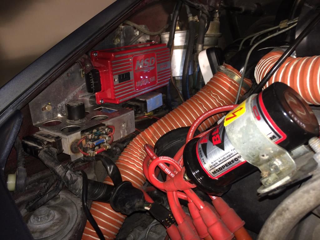

I decided to install an MSD 6AL 6425 to replace my Permatune on my '83 SC. I am pretty mechanically competent but I have zero experience with the electric side of car modifications, so this is my first time.
It seems to me that whomever installed the Permatune in the past completely butchered the wiring - or like I said I am unable to decipher the wiring due to lack of experience. I need help identifying the following:

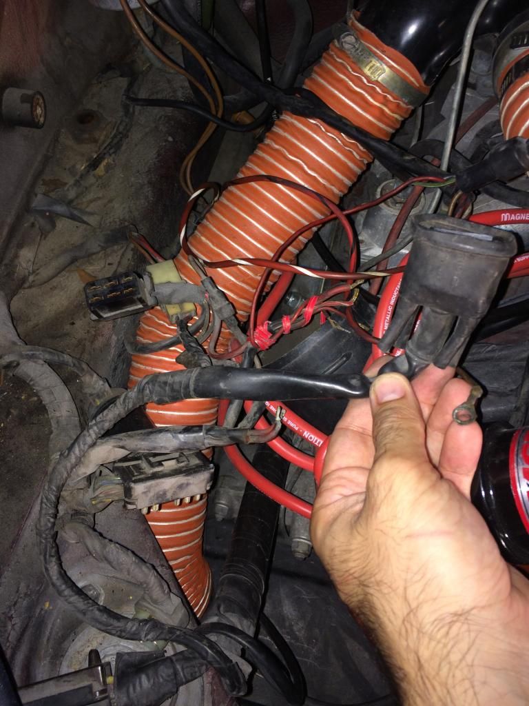

There wires are coming from the topside of the engine wall
There are coming from under the fuel filter
This is what the current situation looks like
I'm currently mounding the MSD to the aluminium bracket but I'd like to get the wiring sorted first.. Any help on identifying the basics and cleaning up this mess would be appreciated

All the wires that connect to the MSD are in the connector you are holding in your hand, not sure what the cable coming from behind the fuel filter is, you're going to need to look at a schematic. Your msd comes with various wiring diagrams depending on install. I installed their Streetfire in my 83 and aside from having to flip flop the dizzy trigger and shield it was as drawn by MSD. Warren

The brown wires are grounds of course. They should be connected to the ground point to the left of the fuel filter. The red/black and red/white wires go to the defroster on the rear window.
That's the test port for checking dwell.
Hmmm... well that's a rat's nest. I went with the MSD Streetfire. I posted the wiring on the MSD side and the engine wiring harness side. I don't think it's different between the two. Let me find the thread and I'll post it in a few minutes.

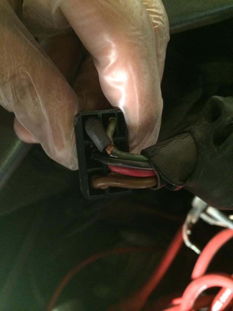

Ok, I visited the PT website and saw the connector pin setup Perma Tune High Performance Ignition Systems
Pics
Can anyone help map the existing connector setup to the MSD connector?

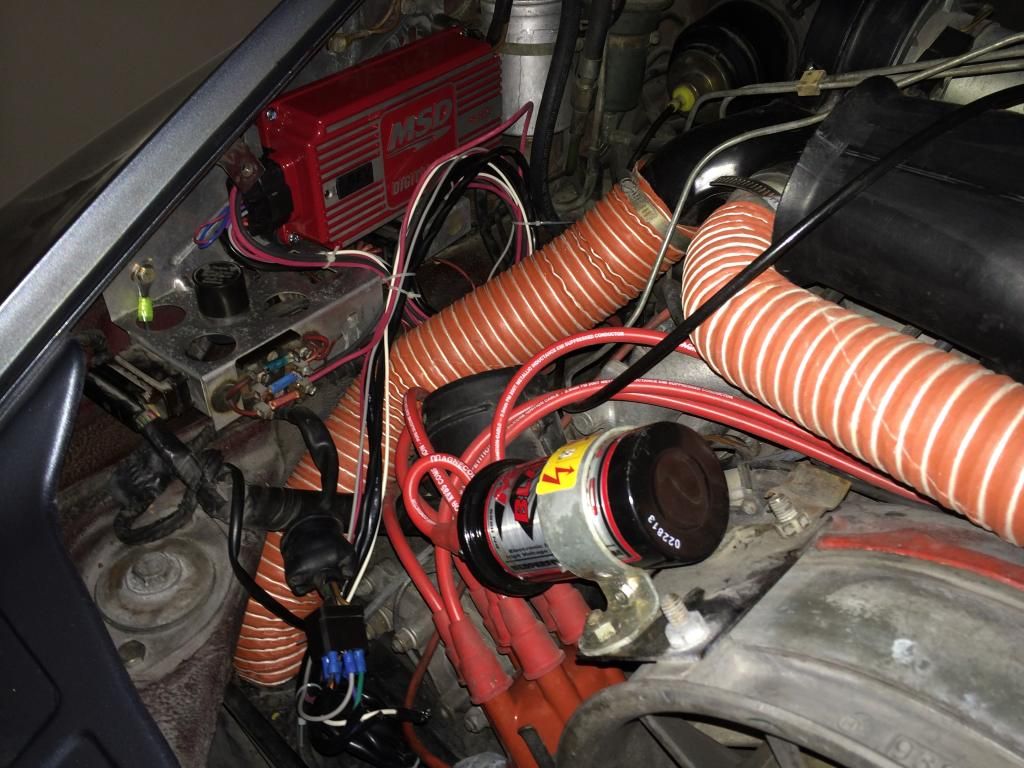

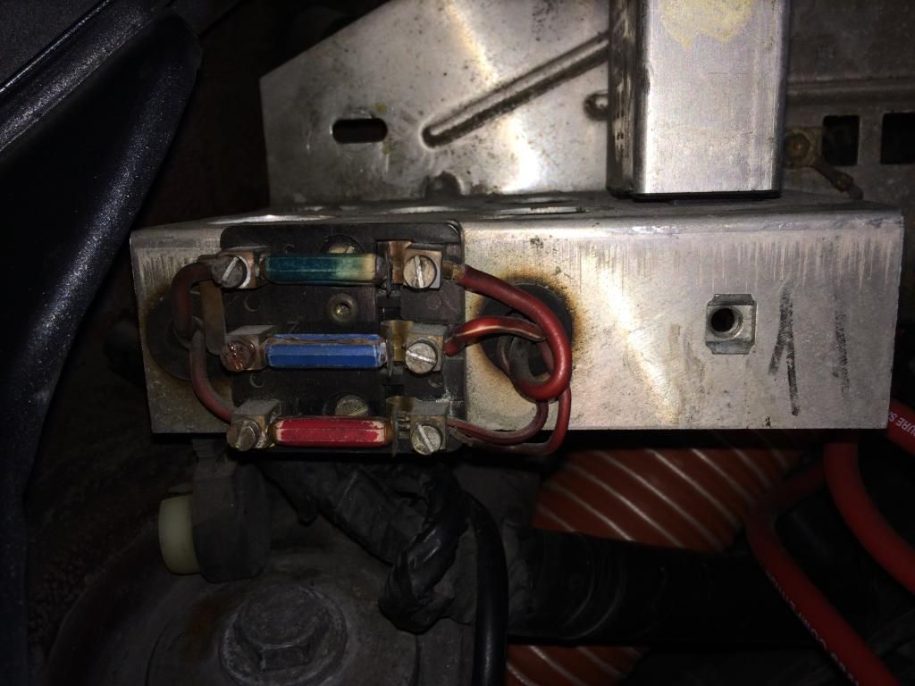

I think I've figured it out. The only question is, the heavy red wire should connect to the fuse panel, however I have 2 wires already connected, both heavy red. Would one of these be for the now gone PT box?
This is what it looks like now, without the wiring

That 6 pin plug you show for the Permatune has almost everything you need. The green wire goes to green on the MSD, The shield wire with the black cover on it goes to the purple wire, The brown wire is ground. The red wire is probably power (check with a volt meter). The other 2 wires go to the coil. The only thing missing is a second power wire. On the MSD the fat red wire is unswitched power and the thin red wire is switched power. On my car I hooked up the unswitched power wire to one of those 3 fuses (check with voltmeter to find the one that is hot all the time). I hooked up the switched power to one of the 3 fuses that was hot when the key is turned on.
You can either hook up through the Permatune plug or run your own wires to the places they need to go.

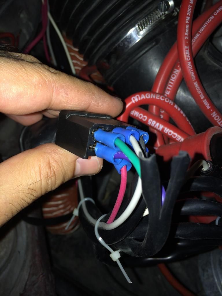

Had the wires flipped (d'oh).. used the following and it worked:
1. Heavy red for constant power goes to one of the top 2 fuses on the rear 3 fuse panel that has an open terminal, fuse appropriately (top one?)
2. Heavy black ground it to a screw holding the fuse panel in place or other suitable good ground
3. Red connects to red wire in 6 pin connector (Center bottom)
4. Orange connects to white wire in 6 pin connector (Right bottom)
5. Black connects to the 2 brown wires in 6 pin connector (Right top)
6. Grey connects to purple/black wire in 6 pin connector (Center top)
7. Violet Connects to the green wire in 6 pin connector (Left bottom)
8. Green connects to the shield wire that may have black heat shrink in 6 pin connector (Left top)
What the best way to double check that everything is ok?

Seems the violet and green are the 2 wires that occasionally need to be swapped when it won't run well. The Streetfire seems to like them the other way.
