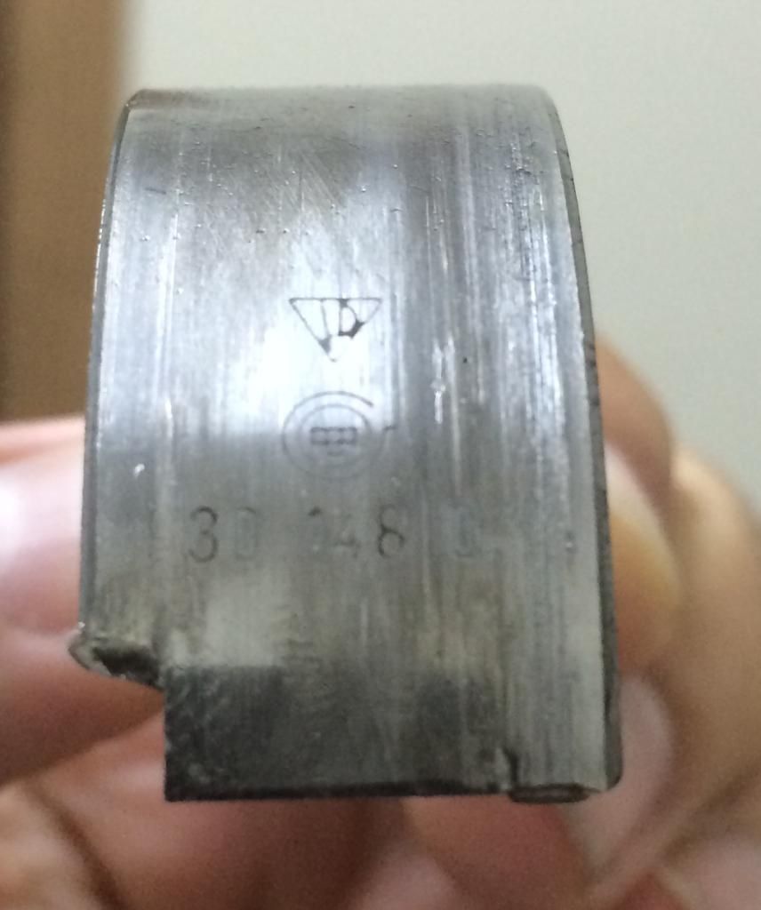

One set of rod bearings looks like typical wear, although very worn due to hard use and possibly thin oil allowing contact with the crankshaft at high rpms. The speckled rod bearings look like failure of the bearing material itself coming loose from the bearing shells.

Can you tell if the bearing shells are the 'original' Porsche or a replacement like Glyco, are there markings on the backs?

This is the back of the failed bearing.. notice the corner is chipped

zelrik911 09-14-2014 04:13 PM
Bearing moving inside rod??
I am no expert but it looks like the bearing may have been moving inside the rod.
Was it the locating tab that has been broken off at the corner?
Perhaps some more experienced people can give an opinion on this and the origin of the bearing shell.

GT2BH 09-14-2014 10:25 PM

Close inspection of the crank doesn't show signs of the bearing having moved - even when I touch it - but I'm no expert either. And yeah, the locating tab was broken off :(

KTL 09-15-2014 07:30 AM
Original Porsche are Glyco. So the branding isn't a way to tell originality. Need to look at the date code stamping on the bearing shell.
Once the bearing wants to move, it's going to spin and then the bearing gets completely smeared. Those bearings haven't spun, but they sure do look crappy. Somebody may have scuffed the back side of the bearing to remove the plating and give the bearing some bite in the rod?
If you can't feel any ridges in the crank with your fingernail, you're probably OK. Just clean it up with solvent and then treat it with rust protectant or motor oil. DO NOT leave the crank dry or it will rust very quickly.

That was the only bearing which was completely gone - I am told it might be an oiling issue. I'll be packing everything up this week and shipping it out for machining and will order all the other necessities as well. Now the waiting begins (and the money is spent).
