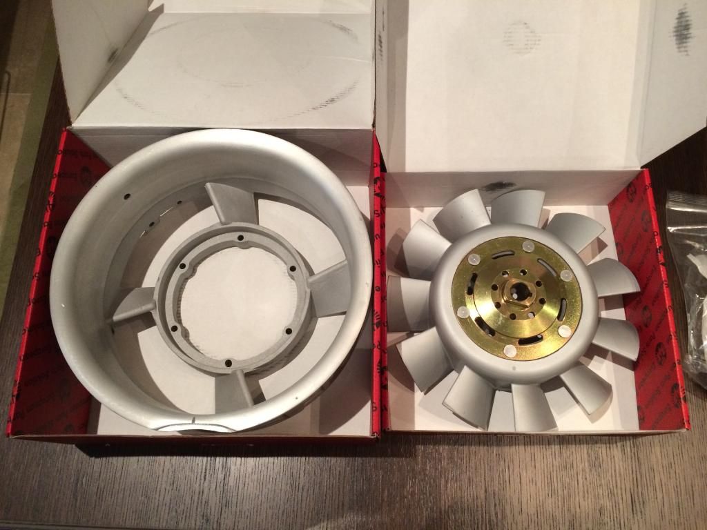

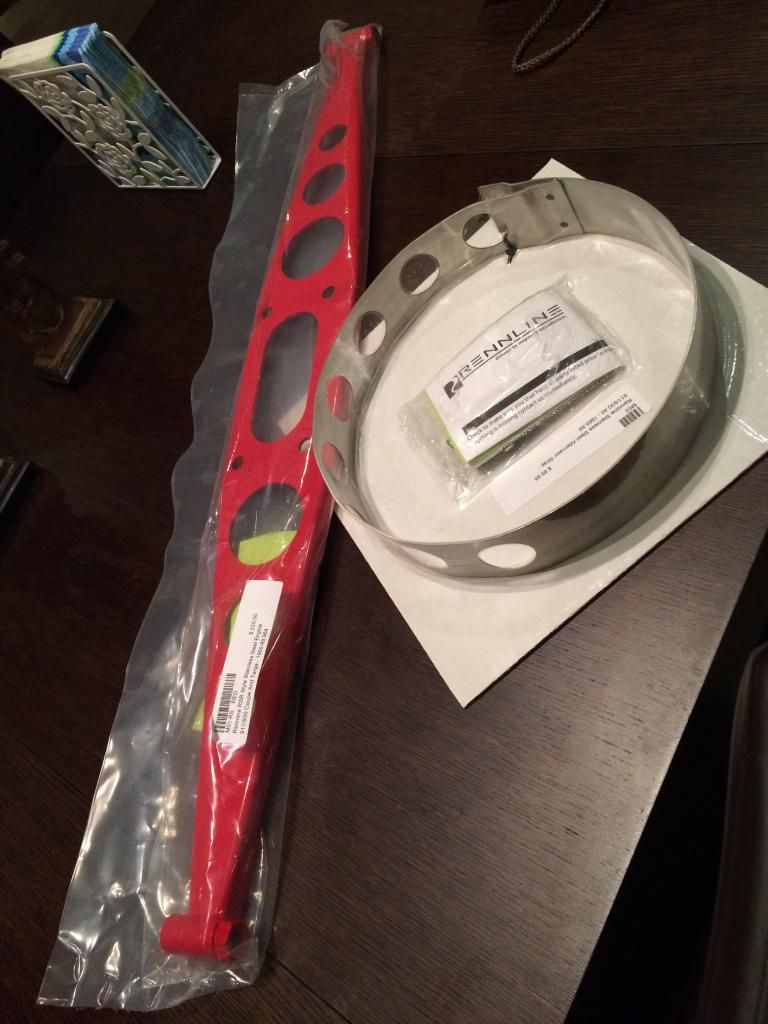

GT2BH 09-24-2014 09:11 AM
Things are trickling in. Main shipment from Pelican is outstanding and just got an email it will be delayed. Second time this happens - the shipping time on the website is wrong. Last time it said shipping in 9 days and its been over a month :(
Rennline stuff - RSR Engine Carrier and Fan Housing Strap :D

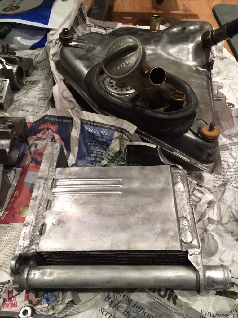

GT2BH 10-09-2014 06:31 AM
Got the first batch of stuff back from ultrasonic cleaning
http://i306.photobucket.com/albums/n...pszumvdfnw.jpg
http://i306.photobucket.com/albums/n...psby1qyt45.jpg
http://i306.photobucket.com/albums/n...ps8mp3atu1.jpg
whiz05403 10-09-2014 06:59 AM
Find any dipsticks in that oil tank?

GT2BH 10-09-2014 11:13 AM
Just the one I dropped a month ago ;)

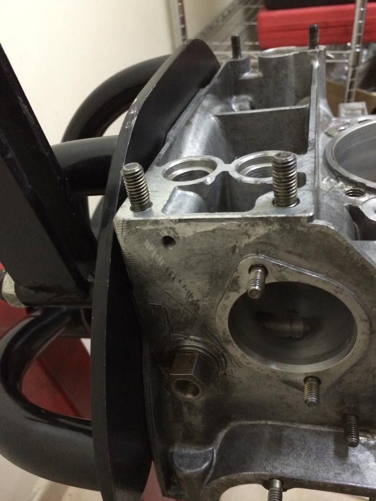

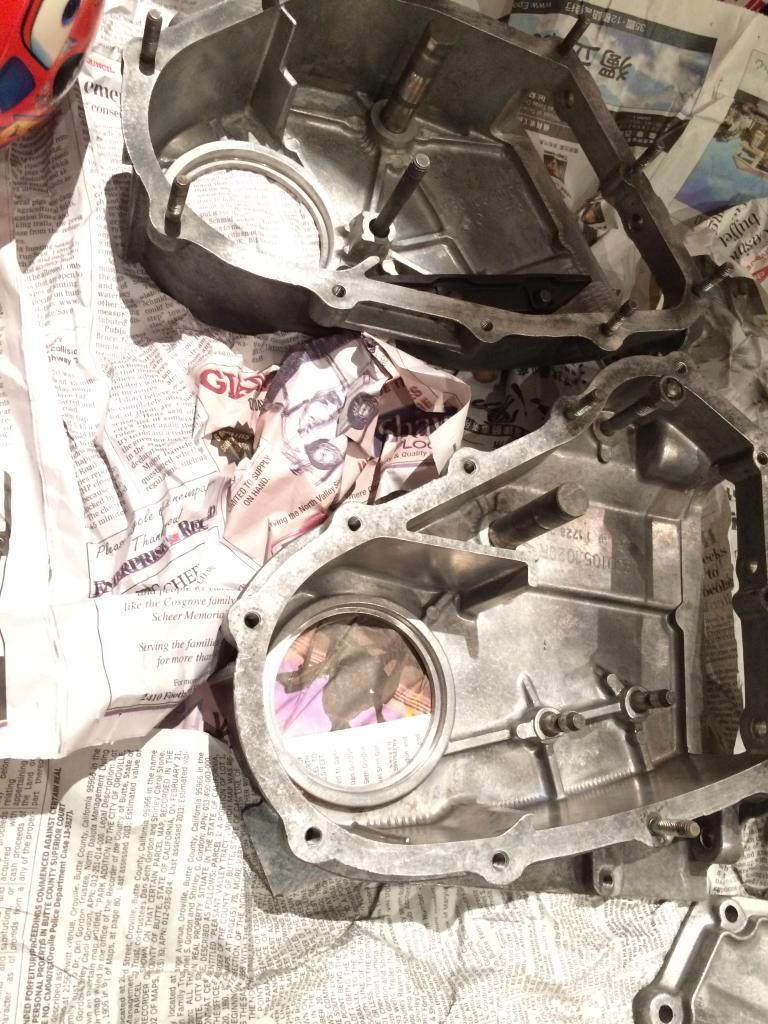

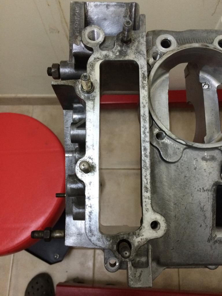

GT2BH 10-12-2014 08:45 AM
Got a question. When removing different parts from the crankcase, a few studs came off (pics below). What is the general consensus on reuse? I ordered new studs that mate the engine case with the transmission since one was bent, and ordered a set for where the oil breather cover mates with the engine, but what about these random ones?
http://i306.photobucket.com/albums/n...pscabbqeym.jpg
http://i306.photobucket.com/albums/n...ps0sgc1cw7.jpg
http://i306.photobucket.com/albums/n...pskcjilvyh.jpg
Got my crankcase halves cleaned but they still have a layer of whatever liquid they used so I started wiping this half down with Dettol wipes. Will go through it one more time then use rubbing alcohol to finish it off before assembly.
http://i306.photobucket.com/albums/n...pshifzelp7.jpg
http://i306.photobucket.com/albums/n...psgrutnfam.jpg

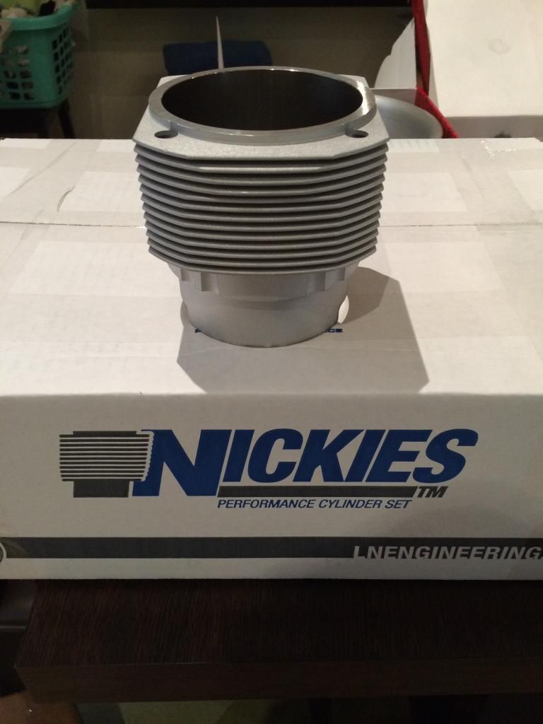

and an update on the final setup:
100mm slip-fit nickies with 9.5:1 JE pistons (essentially 3.3L), 964 cams, Bursch headers, M&K 2-in-1-out exhaust and a bitz EFI kit
GT2BH 10-12-2014 10:21 PM
Anybody? stud reuse?
timmy2 10-12-2014 10:50 PM
I reused any studs that just backed out.
Unless they were damaged.
