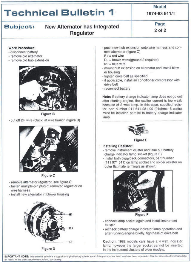

As Timmy2 wrote, you can just have the original rebuilt. If you decide to go with the newer internal type, here is the Tech bulletin.
