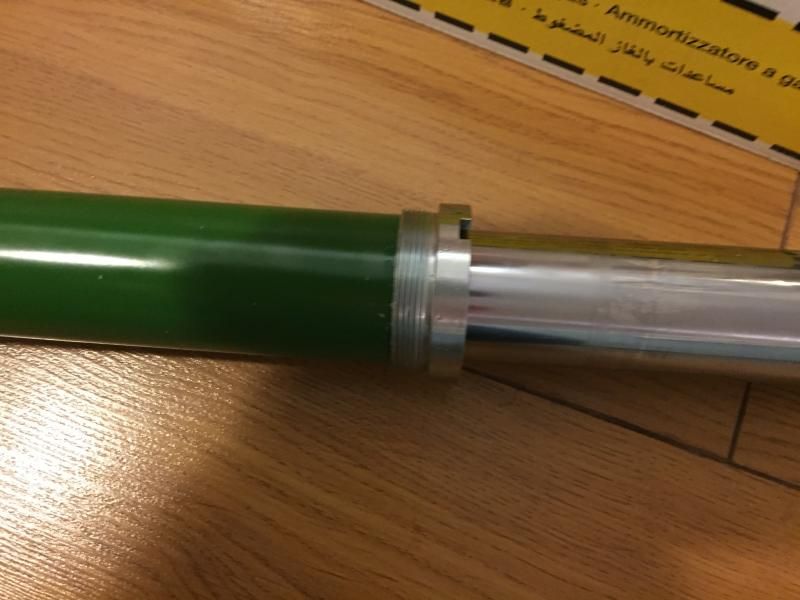

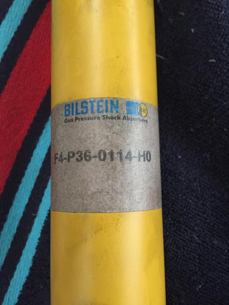

Okay, so I received my Bilsteins today.
Just purty they are
But wait, something is not right? I swear my inserts have the gland nut on the outside, not inside. Hmm, let me check.
DOH

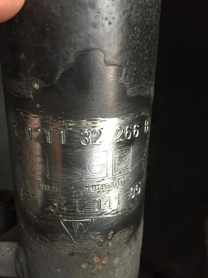

My supposed pre 3/85 build car:
New Bilstein Inserts:
So it appears PO replaced front strut/spindle with a post 4/85 ones.
Can you fellas confirm. I do not recall my housing having threads on the inside at all.

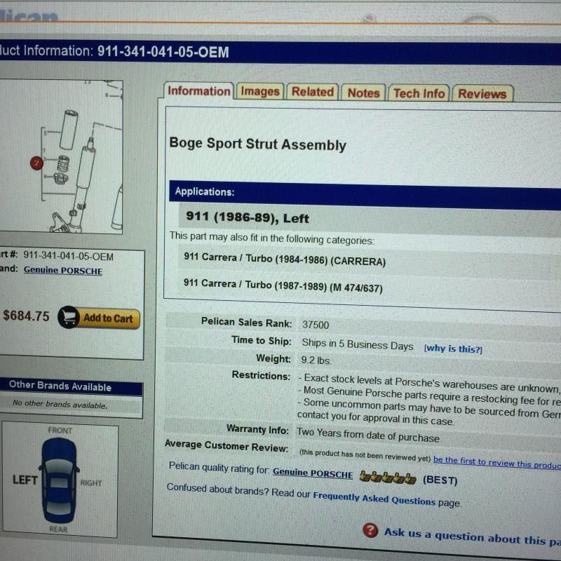

Good News, apparently front Strut Assembly has been updated to 86-89 BOGE Sports :-)
So the inserts were discontinued Bisltein HD's the part is now 34-001141 for 86-89 3.2's
