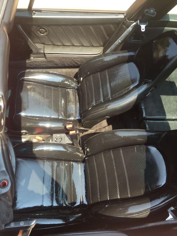

Just to note: On my seats photo above, I used the HD Obenauf which is more like Vasolene. I previously used the oil about 2 months ago so this is in addition to the standard oil. The car has been in the garage for months as I am working on an engine/suspension project and so I have plenty of time for this to soak in. I haven't taken any update photos yet but now that it's been a couple of days, it's almost all soaked up.
I decided to add the HD stuff after I used it on my leather couch and it did wonders on the couch.

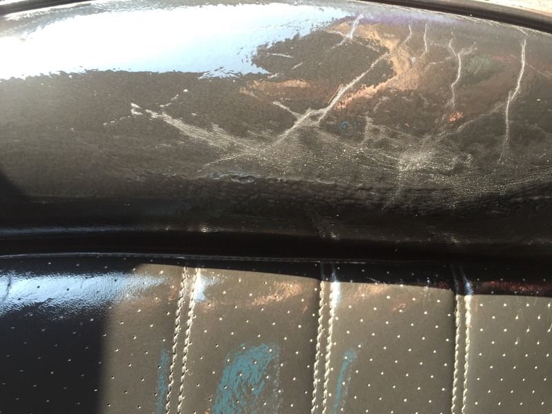

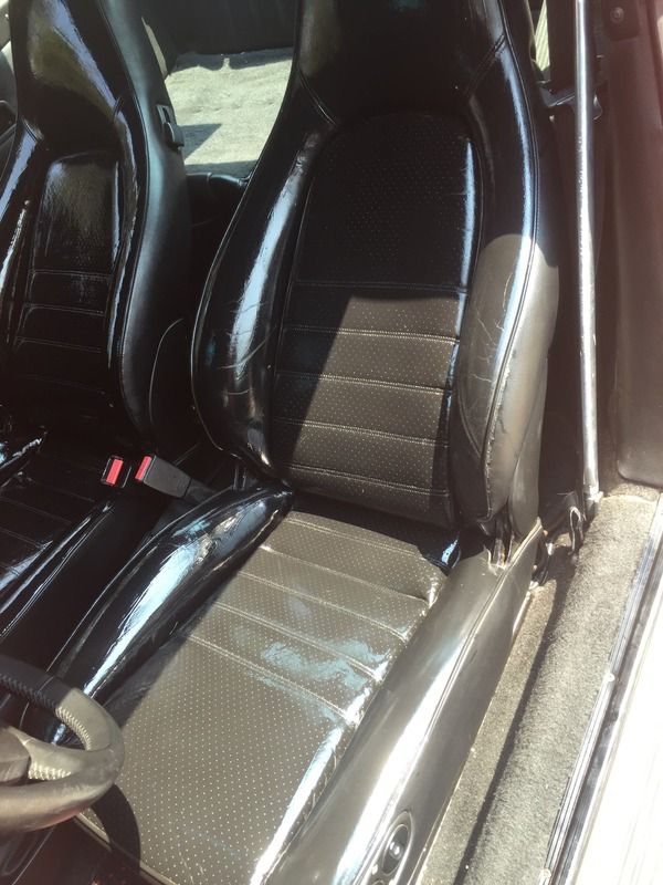

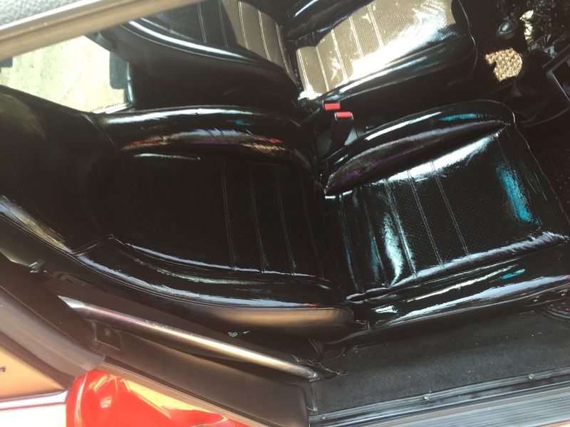

Thought I'd chime in and post some more pictures. I'm in the process of doing another treatment on my Targa.
When I bought my car the seats were hard as rock....to the point it was noted on the PPI. There aren't any cracks and it's been hard to justify putting new leather in when it still looks nice. ....especially since I just spent a good chunk of change on a top end rebuild!
I did my first treatment with the oil during the winter with some results. It was better than nothing and a great value at under $20. Since it's blazing hot in Texas I figured I'd give it another shot now.
I purchased a tub of the LP heavy duty stuff to try as well. On Monday I put a coat of the LP on both seats and let them sit (in the garage) for two days. When I went back out there on Wednesday there were some noticeable differences...but still not the end results I wanted. I applied a coat of oil to both seats on top of whatever LP was left and left it in the garage until this morning.
When I went back to the garage today they were better than before....but not good enough.
I decided to move the car out into the sun to really heat things up and see what happens.
I applied the LP pretty heavily to the warm leather and then brushed oil onto the areas I couldn't touch with my hands....black leather heats up quickly!
I'll repot back with some end result pictures but I'm going to go outside periodically today and apply more as needed. It's amazing how quickly this stuff soaks in.
Car baking in the sun with a sunshield covering the dash and towel covering the rear deck....those areas don't need the extra heat!
How the seats look coated:
Driver's side outer seat bolster after about 45 minutes. The area is almost dry and noticeably softer:
Took the top off to allow more sun/heat in. I noticed this stuff accumulates in the lower seat seams between the bolsters. I didn't apply enough to soak the foam but you want to be cognizant of this when applying. It's a waste of oil and likely an area where the foam will get wet if it sits too long.

I don't think the LP goo is the right stuff for this application, it's too thick and gooey.
I think it's more of a water proofing product. Just the oil should get the job done. Has worked wonders for me.

When it warms up it thins out quite a bit. I tested on a leather iPhone case first and was pleased with the results. The final finish was pretty soft.
My leather centers were seriously rock hard...that's where most of the LP stuff went. If it screws it up, oh well, new leather inserts will be the next step and I'll chalk it up to a lesson on the forum. The bolsters are already noticeably softer.
I'll report back when I wipe everything off.

Have some patience, let it sit like it is and check back in a week, or at least a few days.
I think you'll find things much softer.
