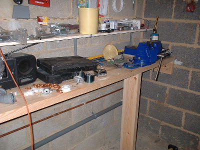

Are you $hitting us, Dickster? You mean to say you don't even have a lousy 'ol bench vice? Start building a workshop my man, or you'll be forever at the mercy of schlocky mechanics and other assorted felons.
doug,
i was so ashamed.............
one new bench, with 5 ton vice on the right. ok it needs tidying!!
i even plumbed in the washing machine (pipes under bench).
then i had a few beers
Rich
'86 coupe
"there you are"
Old 11-27-2002, 12:50 AM
dickster's Avatar
Location: a few miles east of USA
Posts: 3,393
another pic.........
i already used the vice when i did the plumbing, so its already paying for itself!!!!

Old 11-27-2002, 12:54 AM
AirCooledExcellence's Avatar
Location: Essex, UK
Posts: 1,021
Wow, bench building and plumbing, the skills of people on this board never cease to amaze me
Nice Job!

Old 11-27-2002, 02:44 AM
dickster's Avatar
Posts: 3,393
thanks tim, jack of all trades, master of none - thats me!
jakes, i ain't moving from this house unless i find a place with a double garage!!
yeah, its pretty small in there. i made the bench high enough to clear the whale tail which will slide underneath. i have to get the car right in there to make room for a big sports bike that sits in the front!!
the bench is narrow as well - just 18 inches. but its much better having it.
on the subject of splitting the calipers. beep beep, new gaskets?? where??
i want to split the fronts to rebuild them. as far as i know theres no problem splitting them, they're made of two separate units bolted togther, with the fluid running from one to other through an external line (not through the casting).
