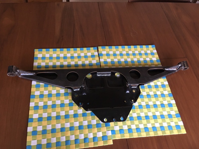

I used the plan above and modified my 964 crossmember for my conversion. I also installed a reinforcement kit on the crossmember while I was at it. Check out page 5 of my build thread and you can see how I modified my tins as well. Supposedly it is much cleaner/easier to modify 3.0/3.2 tins than 3.6 tins.

thabks for the updates fellas. bustarib, looks like page 5 on your build has expored links to the pics. does anyone know if the console from a 79 or 80 will fit with the non-3.6 crossmember?
Yes, it will work OK but, the 3.6 also has an aluminum intermediate spacer/AC mount piece which is needed to fit over the large harmonic double pulley. The 3.2 and earlier console won't fit over the large pulley, so to use it you need to source an aftermkt smaller pulley to replace the harmonic pulley (964 only, 933 has a non harmonic pulley) and discard the aluminum spacer/AC mount unit.

Originally Posted by arrivederci View Post
Yes, and different studs to mount the console.
Do you happen to know the stud length that is needed to bolt the 3.2 console on the 3.6

Originally Posted by mreid View Post
I used a console and brace from a 3.0/3.2. Bolts right up. I removed the heat shield from the rear engine tin and welded up all the holes. Everything then bolted right into place.
What length studs were needed to do this?
I'm not sure what exactly I used. But looking through my records, I know I bought two studs from Pelican.
999-061-056-02-OEM $3.00 1 $3.00
Crankcase Stud (M10 X 15mm, sold per each, 1 required), 911/911 Turbo
(1974-89)
OEM-99906203902 $3.00 1 $3.00
Genuine Porsche Part: STUD 10 X 50
- This is a special-order OEM part and is non-returnable except for
warranty replacement.
