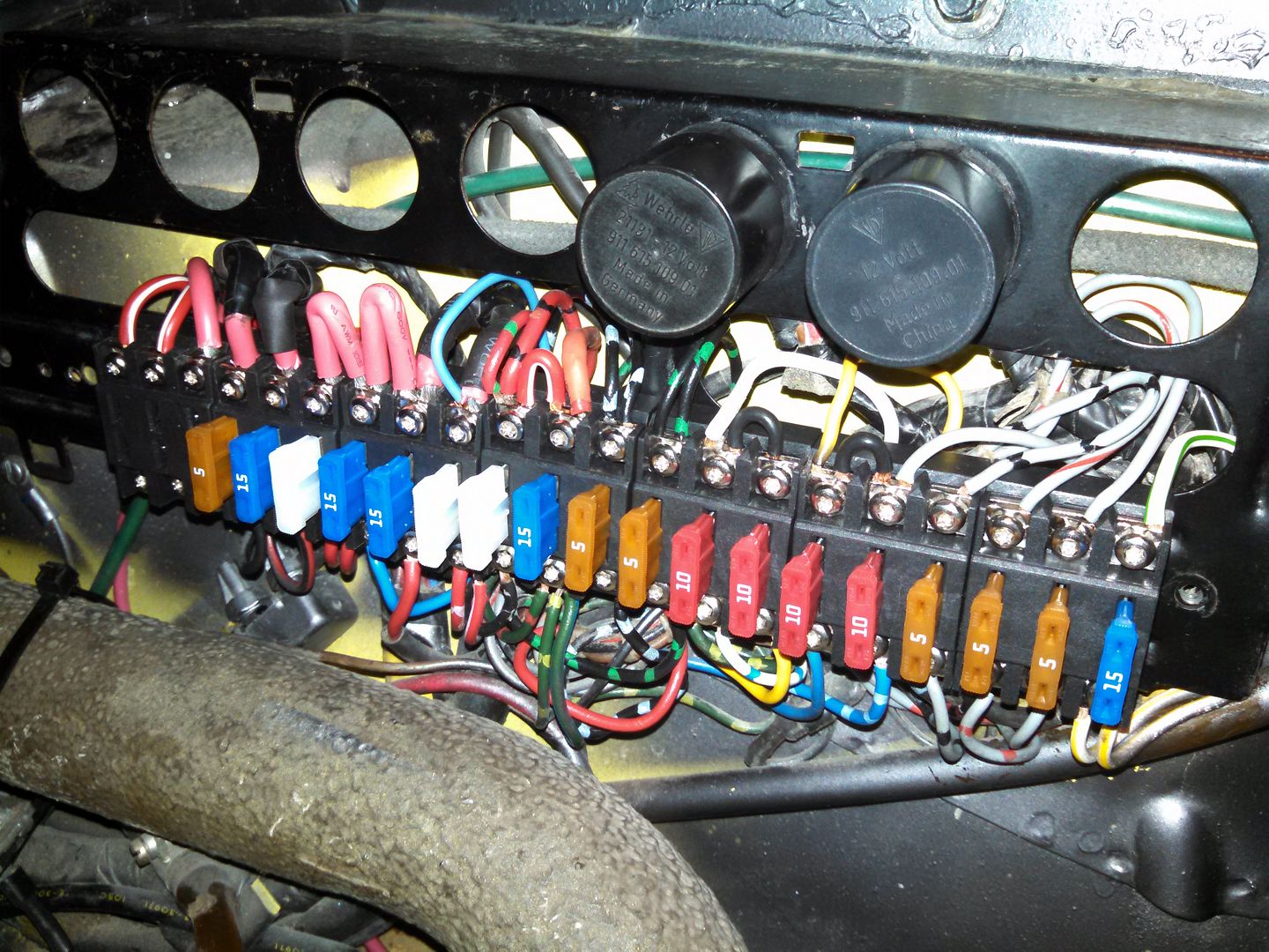

Hello Folks,
I had an issue with my brake lights which finally turned my attention to the ancient fuse panel. My 911 is of the 1974 flavor but this method should work for other years as well.
I hate the old canister fuses and dreaded electrical gremlins that would inevitably greet me at an inopportune time. Fortunately it was while I was taking the car out of winter storage rather than sitting at a stoplight with a soccer mom texting her way up behind me at 55mph.
If you're reading this then you know the same dread of ancient electrical systems that haunted me. I also know there are a lot of options in the market place with some very well thought out products but with price points that are a bit rich for those who are used to rolling their own. I've always been the DIY type - I find this saves a chunk of change often and it seems to have really delivered here. Enough text, here's pics of what shook out and how you can save a few hundred bucks to spend elsewhere:
Here's my ugly old fuse panel with gremlins:
Although not pictured, I organized the wires by removing the top first and numbering with masking tape/marker each wire position (#1 Top, #2 top, #3 top, etc.) to ensure nothing would get mixed up.

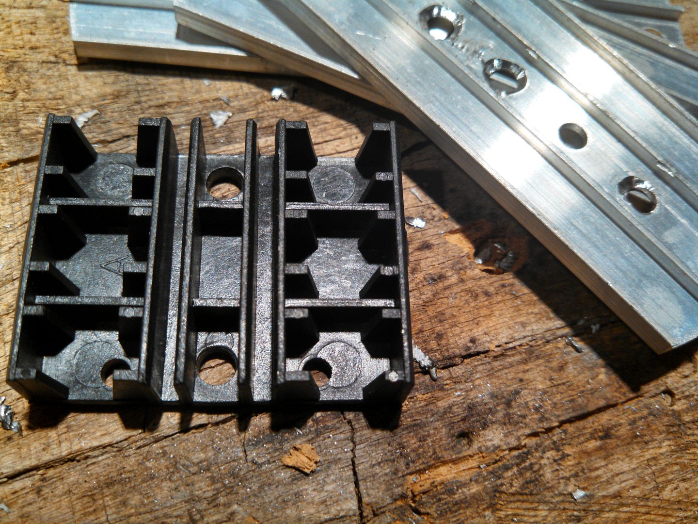

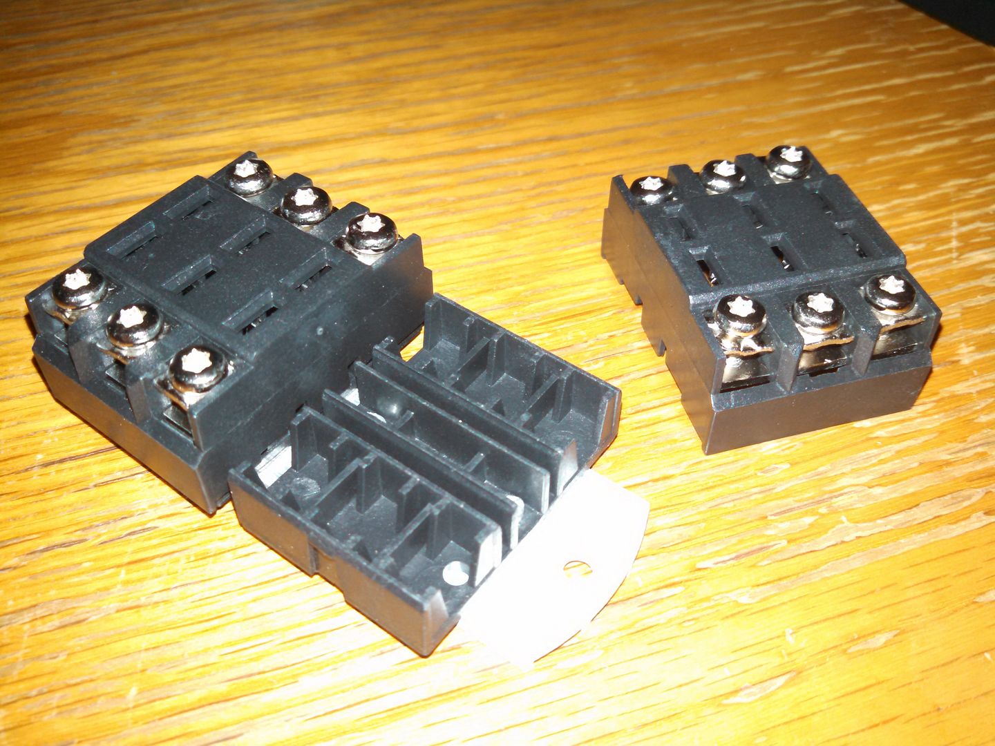

As I mentioned financial benefit of this choice, I chose the Chief ATC blocks; if you buy the 6 position blocks then this is by far the most economical way. Don't be tempted to buy their larger blocks as the cost is much higher. The 6 unit blocks are under $1 per fuse slot ($5.80/6 positions) and expect ~$10 shipping in the CONUS. Here's one with the cover popped off:
The quantity of slots is determined simply by the number of 3 pack units riveted to a strip of aluminum. 4 x 6 packs is enough including extra to do the 3 fuse block in the engine bay and providing a spare 3 slot expansion bay in the frunk. ***DO NOT USE A LEVER ON THE SCREW HEAD OR YOU WILL BREAK THE SCREW, GUARANTEED.*** I used my bare hands on the torx bit to tighten things down and this is more than sufficient. Give each wire a tug to confirm it's secure before moving on.
To make these fit and not look funny with odd spacing, just pry the top off each 3 panel set and drill the rivets out on the back to remove the aluminum mounting panel. Then it's very simply mounting to the stock fuse panel bracket using a drill. I originally riveted the replacement Chief blocks to the Porsche bracket but quickly changed my mind. A rivet through plastic is a bad idea here... DON'T DO IT OR TRUST IT. I found the plastic block would easily work loose of even a properly sized rivet so I drilled all the rivets out (tuition) again and replaced with the trusty old friend, captain zip tie. The zip tie is far more secure looping around each 3 pack fuse block through the original hole and through the drilled holes in the Porsche bracket. The tie is out of sight once you snap the plastic top cover back on the backing panel. Snug as a bug in a rug.

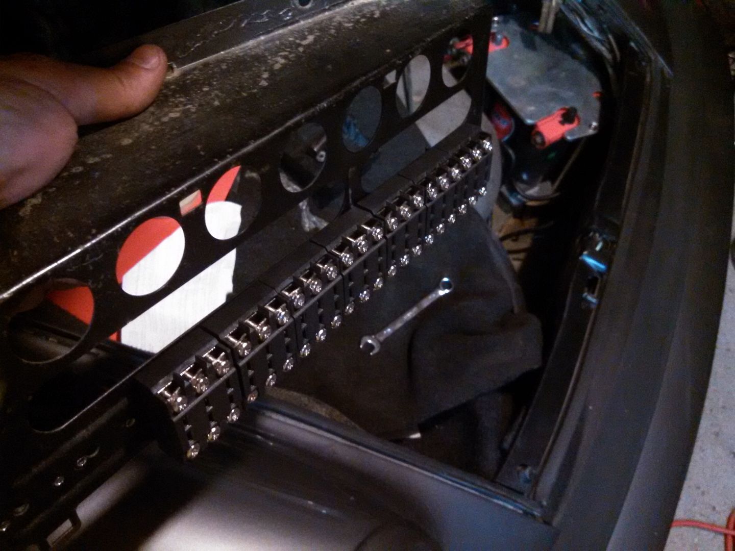

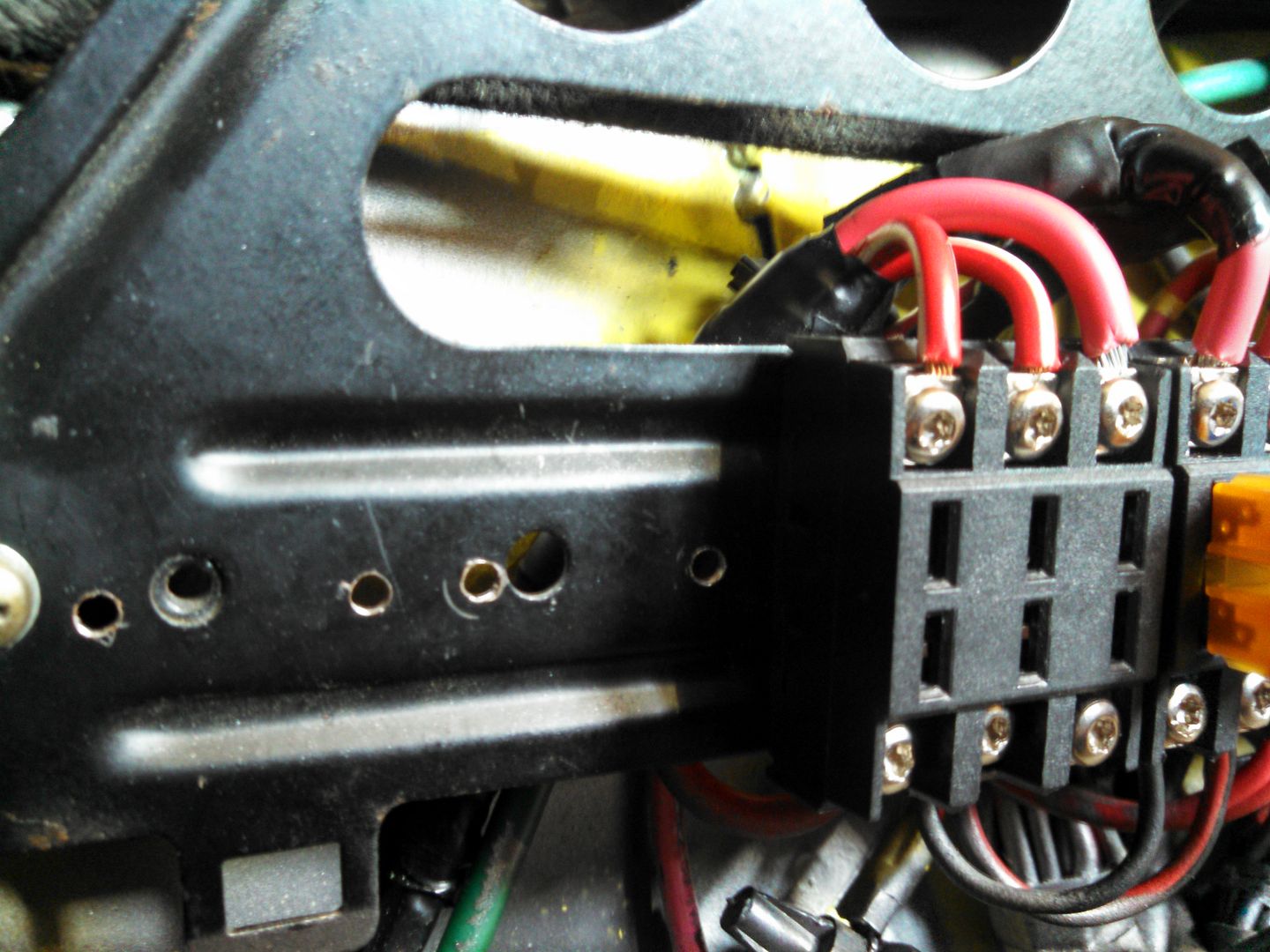

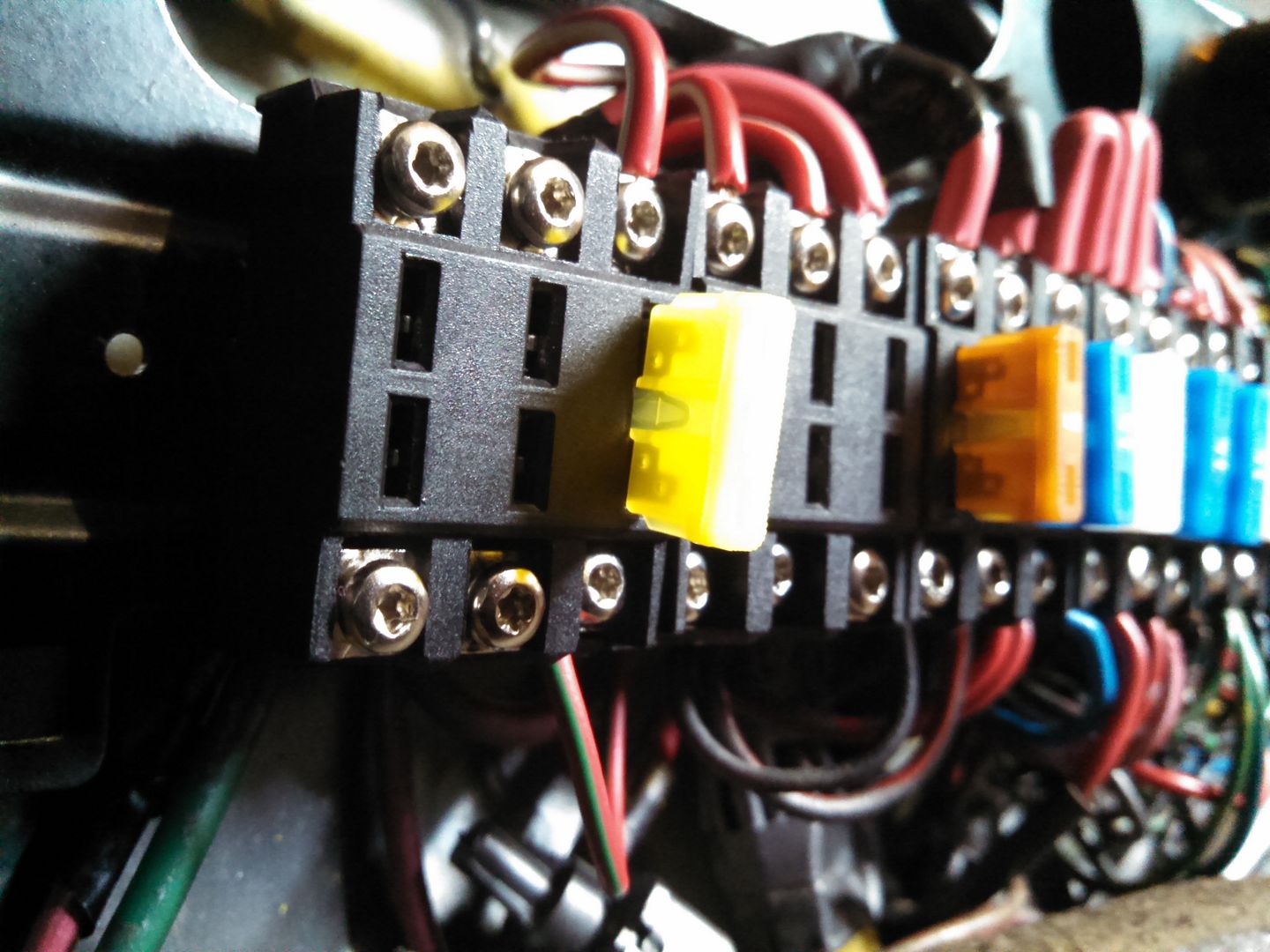

When connecting wires, I found that if multiple wires were connecting to the same position that they must be of the same gauge. If different gauge on the same position/screw then you must strip the wire back on the skinny side and fold it over itself to increase diameter to match the big fatty. Don't try stuffing a 10ga wire into the same position on one side of the screw with a 14ga on the other side as the 14ga will flop about in the breeze like a hotdog in a hallway... which is a fire risk.
I ran an extra 10ga wire from battery to the constant positions for convenience rather than running the jumpers between positions on the panel- this was personal preference for a bit more work/materials but made the job better in the end in my opinion. More power capacity to the fuse panel isn't a bad idea.
I ran an extra 3 position block to the frunk with constant power to the battery (positions 19, 20 and 21 pictured below). I have plans for this panel to include a fan for the oil cooler eventually... more to come on that in a future thread. Hopefully this helps someone else who dreads the fuse box area of their old 911. It's really not that bad of a job and a good piece of mind!

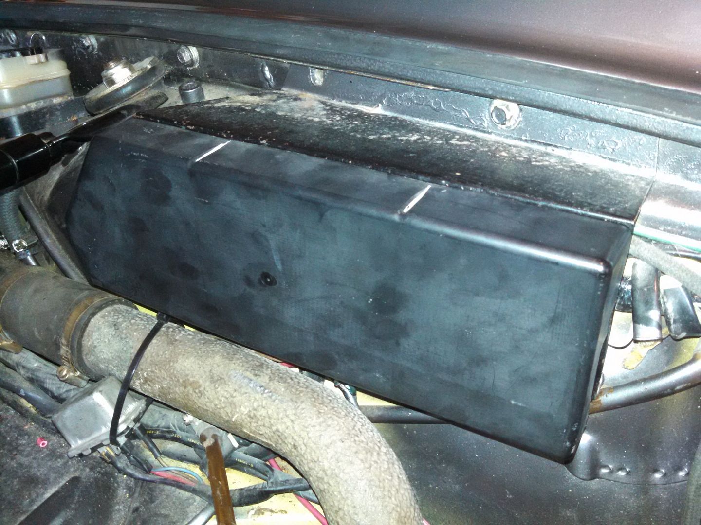

Finished project:
Total cost was under $35... I had shrink tube and other auto electrical materials on hand including extra fuses/wire. I feel much more confident with the new panel and fuses than the old. If you're on the fence, then don't wait... just do it.

Does the fuse box cover still fit over these? It does look like a great upgrade, and I think the idea of making "jumper" strips is a good one as well.
Yes, the factory cover fits back on without any adjustment or interference.

No, I actually drilled new mounting holes and Mig welded 4mm tee nuts to the back. I am using 4mm stainless cap screws for the attachment.
The pair of 2 twelve gang buses just fit the stock fuse panel frame, but you need new mounting holes. You could just use nuts and bolts if you like but I wanted the extra project value and an excuse to break out the welder.

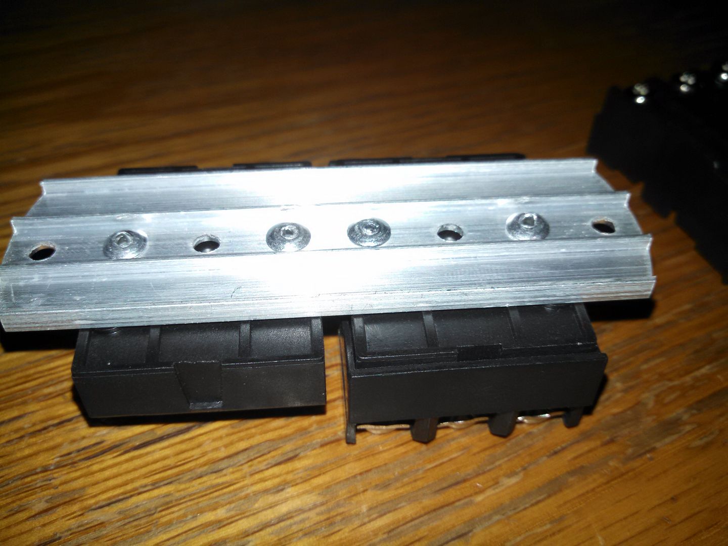

Here's a better look at the original rivets that these use to connect to the aluminum mounting strip:
These are pretty snug- I would be fine leaving these be and mounting the strip with bolts as done above. I chose not to keep the aluminum strips in my project which is where alternative mounting methods came in.

OK, here's a dumb question - why can't you mount the blocks on a homebrew aluminum strip with screws and nuts, and then attach the aluminum strip to the fuse panel area?

For all that work just mount directly to the Porsche bracket I would think... what benefit is the aluminum strip going to do you?
I just took a few minutes and fused my fuel pump circuit as pors1968 recommended and snapped a few more pics as I put in another block. You can see the options to mount are going to be limited to strapping or rivets as a screw doesn't have any shoulder in here:
Had a correct color match/gauge match wire length on hand so it won't confuse the next guy:
Cover fits in place perfectly:
