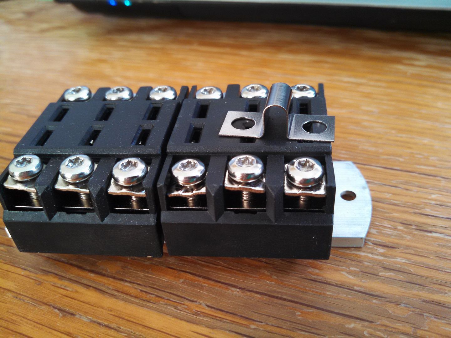

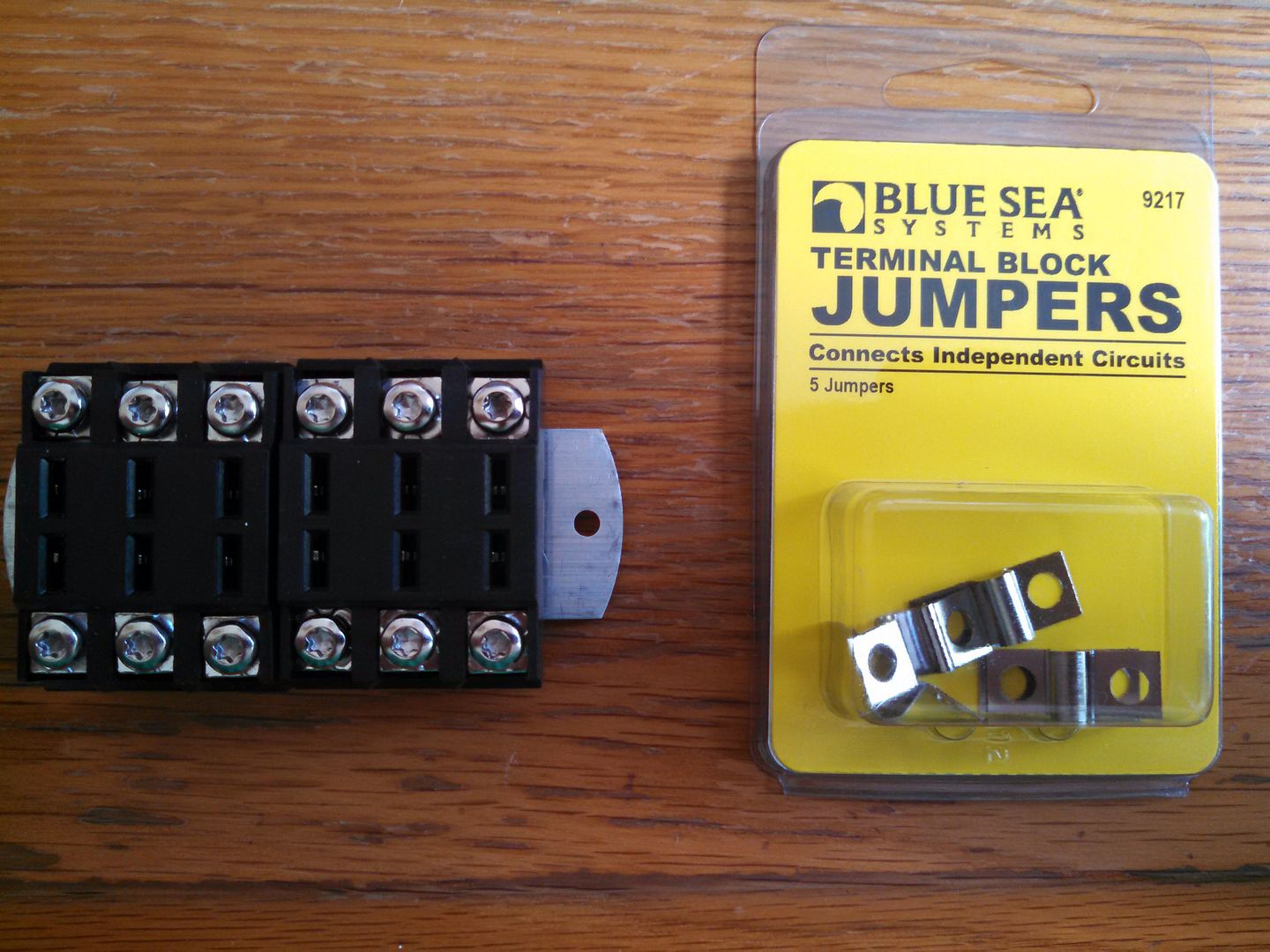

Very nice. I've always wanted to upgrade my fuse box.
I'm confused, why didn't you just unscrew the existing wires, install the new fuse blocks, then screw them is as they were before?
Which fuses are wired directly to the battery? Seems like $10 worth of terminal jumpers would make quick, tidy work of this:
http://www.amazon.com/Blue-Sea-Systems-Terminal-Jumper/dp/B000K2IL1I/ref=sr_1_2?ie=UTF8&qid=1439039615&sr=8-2&keywords=jumper+terminal

Hey there - I'm curious about the jumpers from blue sea as well now that you mention them. I just ordered some to see if they'll fit these blocks. Two different manufacturers so not holding my breath. Should know by this weekend.
Positions 17/18 are constant to the battery. Notice the mess of wires cramming into position 17 from the factory. I ganged some of these together into a single heavier 10 gauge wires to clean things up on the panel.

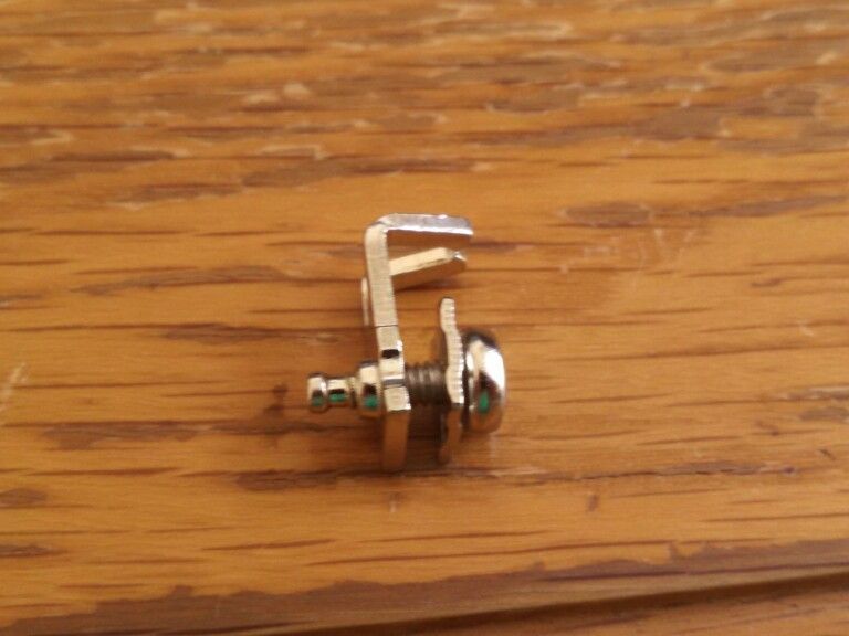

The Blue Sea jumpers arrived today. They're not compatible with the Chief Blocks used here. They might be modified to fit but at that point you might as well fabricate your own from raw copper if you don't want to bother with the jumper wires.
Here's a quick view of why they don't work:
The Chief block screw is rolled on the end so you can't back the screw out entirely... hence you can't get the jumper under the screw where it needs to be. The base of the jumpers are too large in size to fit into the Chief blocks. Even if you squeeze the Blue Sea jumper down to align the holes with the screws, the footprint of the contact on the blue sea is too large.
