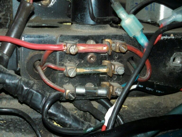

Hi Johnny,
Exactly my concern and why these blocks aren't deployed as primaries off the battery. I'll add links there eventually but it's a different project, different scope.
“Of the value traps, the most widespread and pernicious is value rigidity. This is an inability to revalue what one sees because of commitment to previous values. In motorcycle maintenance, you MUST rediscover what you do as you go. Rigid values makes this impossible.”

Interesting. 30amp on a 10ga; I think you could go higher with a proper block but sounds unnecessary.
5 mins to swap the rear block. Done:

Drove the car around tonight and notice a couple things.
1) Power windows go up and down faster.
2) New hi-torque starter cranks over even faster... perhaps just cleaned the contact on the battery terminal when I added one more 10ga to the fuse panel.
Things must have been a little resistance aged.

Thanks - agreed, it is an upgrade that's low hanging fruit. If your wiring is in decent shape then the job is an afternoon of easy work.

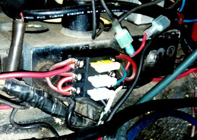

Hi Jonny,
Wire gangs and a second feed to the battery were part of my job pictured here. Why fuss with jumpers on the panel if you can gang and add wire as the harness terminates? I did use some jumpers where it would be a slight bit cleaner as you can see.
Example: 1 10ga wire feeds 4 fuse slots
Why not gang and make the 1 10ga wire divided at the termination point to 4 10ga (or smaller gauge where appropriate) wires to feed the 4 slots? Materials required are only shrink tube, solder, spare wire. Concourse might not take to this approach but then again, concourse wouldn't be swapping fuse panels out either.
Jonny - also want to state that your panel is also extremely well thought out and apparently very well engineered. I've been chewing through my toy budget each month with more than one summer car needing attention/repair so bargains are on the menu for awhile. I'm sure I'm not alone and wanted to share with those on a similar quest for the sensible over the sumptuous.

Hi Fred,
Love your panel solution - a tad more elegant than this DIY approach.
To answer your question, 90A per 3 fuse panel must be the total as each individual circuit is diverse and rated at 30A max:
"Specications:
Rating: 30A max per circuit
Recommended wire size: up to 10 gauge
Termination torque: 14 in lbs.
Materials: Fuse panel housing-thermoplastic
Screw and pressure plate-nickel plated steel
Terminals-nickel plated 110 copper"

Lapkritis,
I just wanted to bring it to folks attention that if you go down this route, the factory harness has to be cut and in some cases extra wire tails added to split the feed wires.
You make the project sound very easy but that assumes people have a good understanding of electrics, wire ratings and such. It also requires lots of patience, note making and attention to detail. Soldering a harness in situ with the annoyingly short Porsche wires isn't easy either. For those reason I think describing this job as 'low hanging fruit' is trivialising it somewhat!
I would say allow a whole weekend and be prepared to encounter foreign wires, PO modifications and other oddities. Even with our 'plug and play' panel, we still get plenty of calls for help.

Hmm, I don't recall cutting the OEM harness. I specifically would have mentioned that...as I am sensitive to the notion. I did skin the insulator back at the end of the wire to expose more stranded wire to allow an adequate amount of material to connect to. This didn't bother me because some wires were also a bit roughed with existing nicks/abrasions/heat damage/probe holes and were an eyesore/unsafe. Where I felt necessary I covered the existing insulator with shrink tube for a repair even if I wasn't extending/ganging on the end.
So with the harness uncut, I or anyone who has the skills to do the work could return this to OEM again by removing any wire gangs, and just adding shrink tube insulator where skinned for job. Rather than tossing my OEM fuse blocks, they went right in the bins that hold the CIS system that was removed for PMO carbs 24 years ago etc. The car is too far into hotrod to justify going back to OEM but previous owners and I have kept all parts thus far removed except for the steel removed for flares. Maybe someday, someone will think that to be a worthwhile endeavor.
I do appreciate the trivialising comment - you're probably spot on as I didn't go into the finest details. I expect nearly each car to be different and didn't think it would be useful to go into what my car needed. Aftermarket alarms, stereos, fog lights, cb radios, neon underglow, and more are likely to be wired in on someone's 911. Questions are bound to pop up during the job but fortunately we have the forum resource to assist each other such as the case with adding a fused link for the fuel pump popped up here.
I think what might help with expectations of the job is assigning it a scale rating. On a scale of 1 to 5 with 1 being easiest chassis electrical job (swapping bulb in interior light) and 5 being most difficult (rewiring entire chassis/harness r&r), I would give this a 2.
Tools/materials to have on hand before starting:
1) Photographs of your existing panels with an inventoried list of wire colors in each position.
2) Labels/white masking tape and permanent marker for labeling wires with position as you disconnect the OEM panel.
3) Soldering iron of at least 30watts.
4) Rosin core solder.
5) Shrink tube of various sizes.
6) Electrical tape
7) Heat shrink ring terminals for 10ga wire if you plan to add an additional feed to the panel.
8) Drill with 1/8" bit.
9) Torx bit for terminal screws.
10) Plastic cable straps/zip ties(smaller size).
The job itself is not a comfortable position to be working in. You'll be hunched over the fender or awkwardly in the frunk like a hen keeping her spare tire egg warm. Not every job is comfortable or easiest. It should be apparent to anyone that swapping a fuse panel in the front of a 911 is going to have inherent organizational skill requirements. If you don't label wires and expect to not need jumpers/gangs added then you're in for a rude awakening.

I had thoughts about mitigating contact corrosion. A quick wipe of dielectric grease on the naked strands before assembly under the screw would to the trick.
