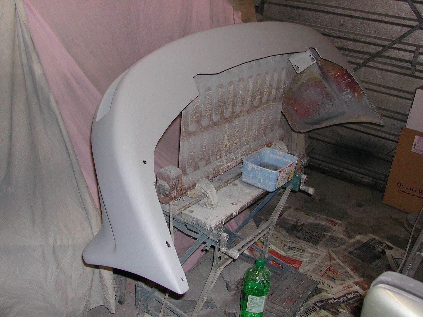

Just got my RSR bumper from Rennspeed. Quality seems solid. The top surface of the bumper seems Far too wide/deep. It hits the body and leaves the bumper shock surface 1-1.5" from the bumper bracket surface. I am assuming that I need to trim the top surface to allow the bumper to move back more. Anybody been through this? Can anybody give me a measurement of the correct width of the top surface.

Not worried about the impact but the bumper needs to move rearward at least 1.5" to match the fender The top horizontal surface seems too wide. The bumper sticks out too far. If I move it in, it should actually mate with the bumper shocks anyway

Originally Posted by LeftCoastErik View Post
... the bumper needs to move rearward at least 1.5" to match the fender ...way
You will need to cut notches in the top surface to let it fit around the wing/tub joining area. Like in the picture below.
They will not need to be as deep, I sectioned the bumper so it fitted even further in, more here Modifying an IROC Fibreglass Bumper

I have fiberglass IROC bumpers on my '74 911 and I definitely had to trim out a notch for the front bulkhead/trunk so it would slide backwards enough. As mentioned above and in my experience, fiberglass parts are rarely simply "bolt-on"...
Not difficult to trim/cut. Just do a little at a time and keep checking the fit as you go - easier to keep trimming than have to add material back after you trimmed too much!

I have that bumper but for the turbo,; yes you have to trim the top back so that it will slide back enough. It's a blessing because once you notch/cut it back, the fit will be perfect.
At least in my case the impact bumpers brackets didn't fit, way too long. I made some hillbilly crush tubes from pvc that fit those holders.

It needs to be notched because Rennspeed makes the bumper "shelf" too deep in the front. My front IROC from MA Shaw required no trimming to fit the '87 911 fenders. They also provided a vertical section on the bumper behind the shelf to allow fastening of the bumper to the original holes in the body. I believe these are the holes for the duckbill rubber smile.
The only trimming I had to do was trimming at the wheel arch for tire clearance due to 16x8 wheels with 225/50 tires. All of the MA Shaw parts were really nice and truly did not require a lot of massaging to look even halfway decent.

My Shaw bumper was 1" too wide for my turbo body (1/2" on each side). I had to cut it in half, remove 1" from the middle, and bond it back together. Then trim the hood area as shown above for it to slide into place. Then it was a perfect fit and I didn't use a smile, only fender trim.
