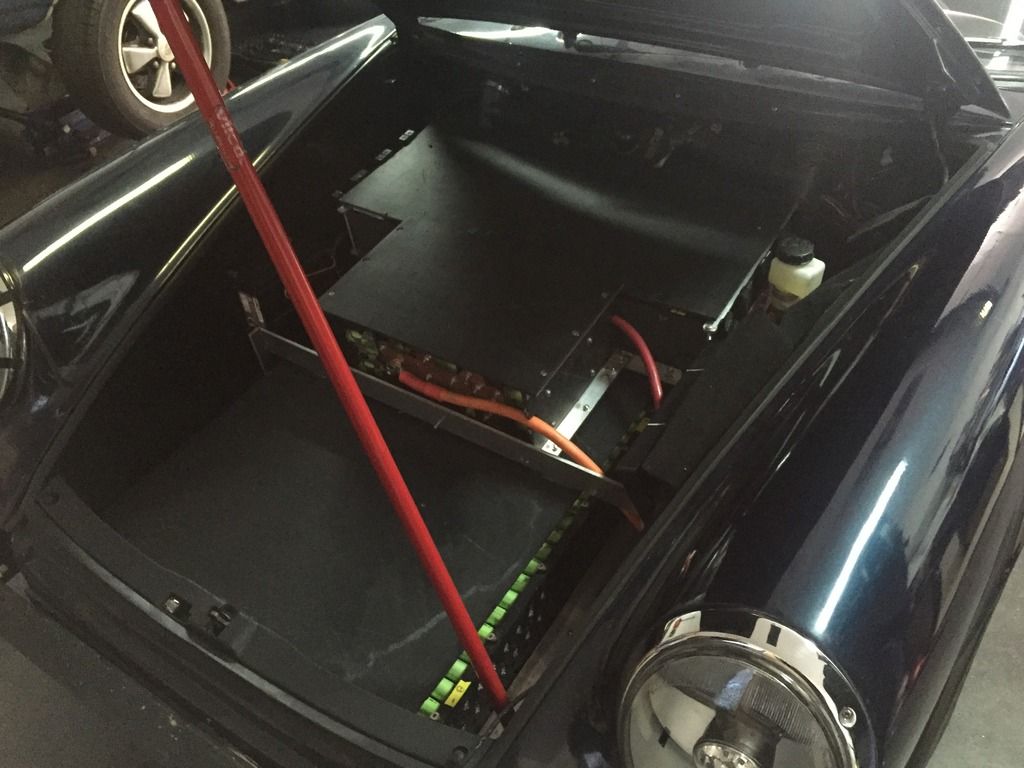

So this fall I had the pleasure to drive a 2100lbs 87 911 with x3 electric motors in the back linked to a 901 gearbox. Each motor was good for 150hp, 200lbs/ft torque (450hp, 600lbs/ft). At max discharge he is producing over 2000amps. He has 3 world records in electric drag racing, runs 8.8 quarter miles, and never lost a slalom he entered.
He removed 1st gear as there was no need.
50:50 weight balance.
Super nice guy. I am sure he would love to chat. PM me and I can send him your contact info. He did everything himself in his garage. If I remember correctly, he is on his second transmission in 4 or so years but don't quote me on that.
His car has a button on the steering wheel that locks up the front brakes to allow burnouts, which are pretty easy with 600lbs/ft torque when you breathe on the throttle, front brakes locked or not. Talk about head snapping torque... you could not wipe the smile from my face that day!

About "three days of regular driving" (not sure miles), or 12 quarter mile runs at the drag strip. His car has batteries and engines that outperform the BMW I8 electric motor in hp/torque, discharge rate potential (key for max torque), and total charge,. Actual range was much closer to "ear to ear". I helped it get down to 60% power in short order in the local neighborhood. My face hurt I was smiling so much. I kept it in 3rd mostly, but shifting worked fine, even if it was eery as hell.
I was at a local BMW club meeting recently. A automotive engineering professor did a talk on basically why electric cars suck... and calculations of how much gas is equivalent to the range of an electric car. If memory serves, the BMW I3 with "range extender" gets you about 220kms, which was about the same as putting 8L in the tank of your typical car. That range tapers off quite a bit with temps 30oC and over, and under 15oC. Optimal reported mileage is only seen at 20oC. You need to read the fine print to learn that one.
Then I got up basically said, you are doing it wrong... electric cars can be awesome! I then showed pictures of the electric 911, listed his quarter mile times and specs, and "said screw battery life and range, when what we really want is crazy acceleration, break neck slalom, and world records!" Just don't take the car to LeMans. You will be first going into turn 1, but will be dead last by turn 2.
Back to the 901 transmission. Like race engines, I am pretty sure he measures the life of his transmissions (g50 or otherwise) in hours when he is drag racing.
