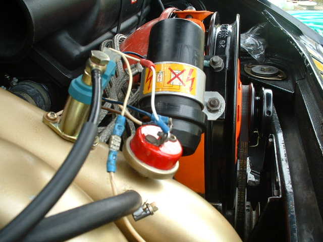

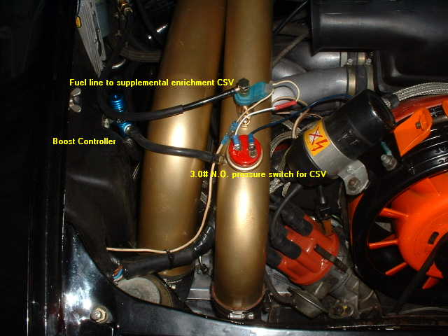

Looked at a lot of possibilites for the supplemental fuel system and decided to go with the stock 911SC CSV. Previously had used 914 CSV and yes even and old Volvo CSV but they just couldn't hold the pressure and consistently leaked.
Well the 911SC CSV doesn't leak at system pressure so today I installed it into the turbo outlet pipe.
The red device is a 3.0# NO Pressure switch. At 3.0 lbs of boost it closes supplying power to the CSV. Used the standard 4,5,6 CIS fuel injector line with banjo bolt connection for the 911 CSV.
This supplemental fuel line easily attached at the fuel filter with a brass T connector inserted into the line. Earlier picture showed that.
The other rubber line is the control pressure line to the Tial Co 35mm wastegate. Curently I have the .5 Bar spring in it and depending how that goes will add a Slowboy Racing manual boost controller to manage boost between 7-11lbs.
Should be burning rubber tomorrow.

tsuter,
I'm no turbo expert, but doesn't it make more sense to have the pressure switch for the fuel enrichement after the throttle plate?
The situation I see is that you are at part throttle with no boost to the engine, but the turbo is already at full boost. You are now dumping fuel into the intake when it is not needed.
I see this situation occuring when your at high rpms, full boost and you release the throttle and let the engine slow the car down. Boost pressure drops to zero after the throttle plate, but the turbo has rotational inertia and maintains pressure before the throttle plate (in your gold pipe). Fuel now becomes excessively rich and will cause backfiring and other problems.
just a though....

So that's where all that nasty back firing's coming from!
No sorry - I don't get any backfiring or big puffs of fuel smoke. The boost seems to drop fast enough when lifting the throttle that there are no problems. I did have problems with leaking CSVs that couldn't handle 75lbs of system pressure. The new one is the stock 911SC CSV and its not leaking - at least not yet.
However I am considering a DV between those pipes to sustain the spool up a bit on shifts.
I have a Bosch 0 280 142 108. Porsche P/N is 993 110 337 50 The P/N was for a 930 I believe. Black plastic L-Body.
Have to find some flanges and decide whether to put it underneath or on top. It would activate on vaccuum.

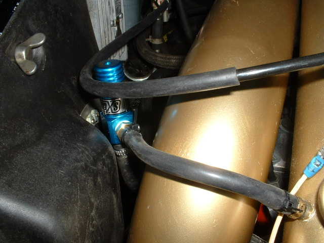

Installed the SlowboyRacing manual boost controller yesterday. TurboXS model. Installed in line with the boost control line from the turbo outlet pipe to the wastegate and mounted on a little bracket attached to the rear fuse/relay cover. That is the fuel line to the supplemental enrichment CSV wrapping around the top.
Here is a wider shot showing all the local plumbing. Could have hid this more but it is easy to get at on top.
