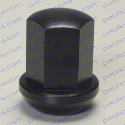

Getting ready to replace Turbo Twist wheels on my 911sc with Fuchs my son just refinished for me. Would appreciate help on using the correct lug nuts. Current lug nuts on turbo twist wheels are very light-weight black closed-end lug nuts. Will they work or do I need to buy different lug nuts for the Fuchs? One more piece of info -- I'm told my Fuchs are turbo wheels as identified by the area where the lug nuts seat (counter sunk). Does THIS fact dictate different lug nuts?

Your Fuchs should have 9x16 stamped on the inside.
This would mean they are "turbo" fuchs.
They do not need different lug nuts than "regular" Fuchs.

The black closed end lugs are factory aluminum lug nuts. They will have a ball seat as opposed to conical that
Most other makers use. They will work with your fuchs.

All oe Fuchs come w/ 14mm, ball seat, closed face, Aluminum lug nuts.
These come in black oe, there are also aftermarket aluminum versions in black, polished and chrome
There are also aftermarket steel open face mostly used on track cars
and there are also aftermarket Titanium, both open and closed face.

The biggest issue w/ aluminum is that it is soft, no matter how careful you are the shoulders get munged, Al. closed end, these were new 2 years ago
steel is heaviest and rusts unless painted
steel open ended
Ti open ended are lighter than aluminum close ended but are a bit pricey
Ti. open ended
