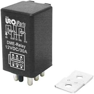

DME or ECM? I bought a new DME and replaced it.

The DME and ECM are the same
or
did you buy this?

I replaced the relay and inspected the engine control module.

What brand of DME relay did you buy?

- I bought an original KAE.
