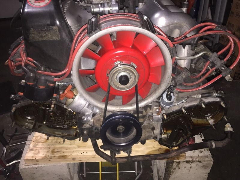

OP,
I will open mine and show you. Give me a bit of time as I am doing a partial top end right now
I had the same issue when I attempted to use VW Bug U-Joints, they were too long and too weak but same spline receivers.
