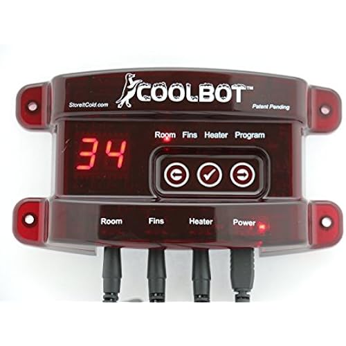

Hey Karl, speaking of "padded rooms"; I use an electronic controller very similar to what you've described in this thread to control/override the thermostat of a window a/c that I use to super-cool my bedroom for sleeping purposes (I sleep best in temps below 60 degrees F - mid to low 50s are the best for me). It is a self contained unit that measures room temp, has a heater element that attaches to the a/c's evaporator temp probe, and a frost sensor for the evaporator. The only "trouble" for automotive use is that it is 120V (AC) powered (not to mention it is costly).
It is fully adjustable for temperature, frost sensing sensitivity, etc.
This is one of the most pleasing gadgets that I have ever bought for myself - have been using it every night for a little more than two years and works perfectly.
I discovered this little gem when I was doing online searching for instructions on how to build something similar since window a/c units are only capable of temps of about 64 degrees, and simply replacing the thermostat with a toggle switch does not work since the evaporator then freezes up (I tried this, buttofcourse).
https://www.amazon.com/CoolBot-Cooler-Controller-window-conditioner/dp/B003VSLTAI/ref=sr_1_1?ie=UTF8&qid=1476040680&sr=8-1&keywords=koolbot
Padded room with snow maker... way to go Rono. You chill for sure. That's interesting gizzmo. Looked into some units like that but they were expensive. Funny that you tried to over-ride system to improve... Fookin u at the helm Bro!
