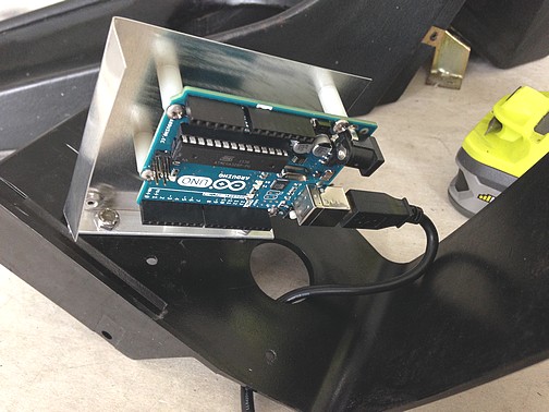

Arduino... mounted... in wrong position. Yeah, this is what not to do. Looking at this now I realize display panel would have to be removed every time Arduino is reprogrammed (given units inflexible data cable near the socket.) Since there'll surly be a number of reprogramming events to fine tune the system once its running, easy access in this regard would be smart to build-in now. Thinking this through on the fly... makes sense to leave data cable connected to Arduino and have other end resting in console's access hole. Minor adjustment.
No worries on perpetual reprogramming John!---I'll learn code.

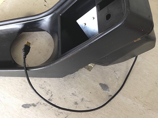

Data cable in place. Moronic positioning of Arduino for sure. I can wake up now.

Old 10-20-2016, 10:11 AM
Jonny H's Avatar
Join Date: Jul 2013
Location: South East England
Posts: 1,708
How do you plan to power the Arduino?

Just saw John's digital rendition of screen layout. Impressive piece of work John!
Ard is repositioned. Data cable now remains permanently connected to it. When not uploading, cable can stuff into front of console. Last bits---potentiometers---are now ordered. (One is for "Set Temp." Other is to adjust screen contrast. Been trying to find shaft that will fit Porsche knob without having to mod parts. May have succeeded.)

Old 10-20-2016, 12:22 PM
Discseven's Avatar
Join Date: Oct 2012
Location: Miami, FL
Posts: 4,461
Plan to run power ON/OFF from stock fan speed switch. Have heard 12v needs to be stepped down to 5v for Ard. Also heard that Ard can be fed 12v and will sort it out itself. Safer route is obviously a step down. What's your take Jonny?
