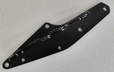

After 3 years and 8 months of mostly procrastinating, I'm putting the engine back in my 1983 SC. Needless to say, after that amount of time, there's a lot of "discovery".
And I have a part left over. It's pretty thick, 3-4mm. It seems important. It has a rib welded to one side to make it stiffer.
And it was in with my Porsche parts, which are mostly separate from my MGB parts, my Ford 8N parts and my John Deere parts. But not always.
Can anyone identify this?
I've look through both of my Wayne books and the Bentley manual, no sign of it anywhere. The only stamping on it says 1130 VE. It had some surface rust, so it was somewhat exposed. I did put a coat of fresh paint on it. I still have quite a bit to bolt back on, like the rear bumper and oil lines... might be from there? I just don't want to have to take the engine back out, once I get it installed.
Thanks much!

Does it have a part number?
It really does not look like a Porsche part
Maybe ac mounting bracket?

Yes, AC compressor mounting bracket (actually, strut brace.)
http://www.autoparts.loc8apart.com/nav/auto-part-alt/Porsche/911/Air-Conditioning-and-Heating/compressors.php

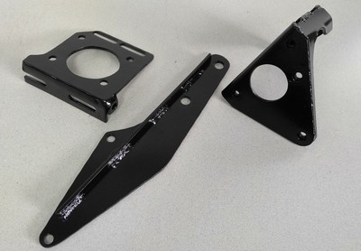

Awesome, I guess it was in there somewhere. And now I can put it on the shelf next to the compressor...
Thanks much!

And maybe label it...
