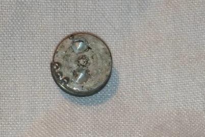

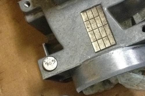

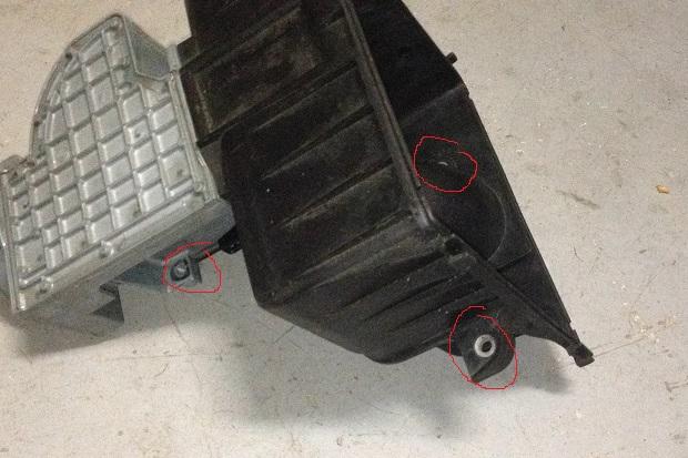

No you do open the unit.
Remove it from the car.Remove the el.plug there are 3 nuts which holdss it in place.then big hose clamp on top.On the right side is a breather hose bracket where you remove 2 phillips head screws.(also remove the filter with the cover 1st.)
Behind the filter is the 3rd nut to hold it in place.Once you have it out you drill 2 mini holes into the alu.plug and remove it by pulling it out with needle nose pliers.
Here is the alu plug.
the plug comes out here do not bother to put it back no need to.
Ivan
