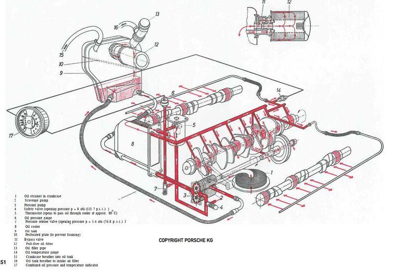

Hi here is some basic info regarding oil travel..;-)
Ivan
and here is one more
