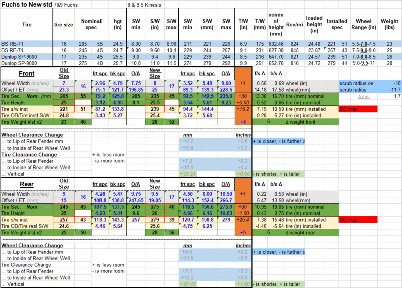

just going by the official Porsche specs for width of an '86 Carrera compared to a T/L or 930
width
Carrera 1652mm
T/L or 930 1775mm
difference is 123mm at the rear fender
here's what i've found to be at or at least very close to the limits of an SC/Carrera wheel well
here are the specs for the widest wheel/tires I've been avb;le to fit w/ a lot of work and some compromise on ride height, on the left is a typical 16" Hi perf Fuchs setup on the right maxed
