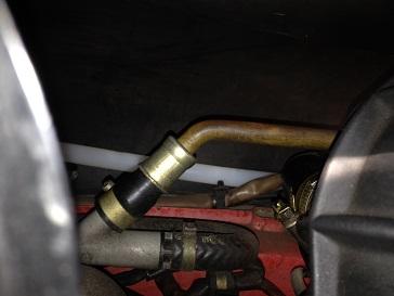

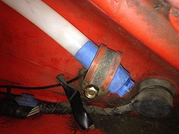

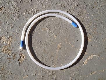

This is what I use

Flojo ....i have the same in my 911 .Did you know it is actually patented in Czech Republic by Mr.Cervinka?

Originally Posted by Flojo View Post
This is what I use
Flojo, could you tell me which model BlazeCut this is?
The BlazeCut website shows four models, TV100FA, TV200FA, TV300FA, TV400FA. I gather that the higher the number the longer the tube and, hence, volume of extinguishing chemical. What the website sorely lacks is a chart or technical section indicating sizes and recommendations for specific applications.
This looks like a great product and you can purchase it directly on the U.S website. You'd think that if they're willing to sell you one, they might be a bit more helpful in the selection.
