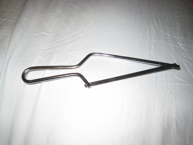

*sigh* i needed that well i just came back from taking a look and the "thingy" that i was referring to is the "fulcrum/tube" i thought it was part of the bracket but turns out its part of the block well now I'm wondering can i just cut a little piece of of it so i can slide the bracket up or is that going to be a bad thing if i do, the speed sensor is broken and stuck in there for good so it inst coming out, I'm going to try pry and wiggle method John_AZ is talking about but if cutting it doesn't damage anything important it would be my next option if the pry and wiggle doesn't work.
I bought this little saw thats just itching to cut something up;)

TSNAPCRACKLEPOP 02-19-2009 12:05 PM
i would pry it out carefully, and if you hurt the fulcrumb part, just replace it with a bolt that has a collar on it, or just a small sleeve slid over the new bolt. OR USE THE CHISEL!! LOL, THE HUMAN ALWAYS WINS!!
TSNAPCRACKLEPOP 02-19-2009 12:08 PM
IT IS ONLY ABOUT 1/4 INCH LONG, SO YOU CAN PROBABLY FORCE THE SENSOR AND BRACKET PAST IT. go ahead, if you bend it, you can round it out with a punch, or cut it off and use a collared bolt or sleeve. Once it is off the car, a smile will cross your face.

Never send a small hacksaw to do a large cold chisels job!
