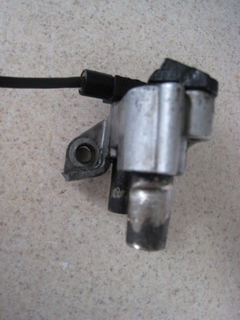

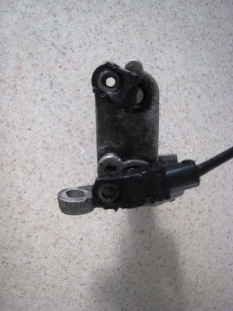

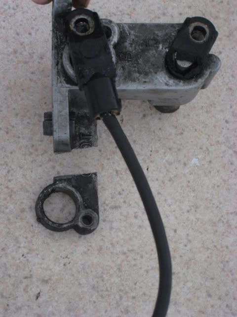

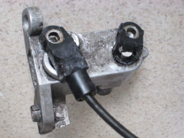

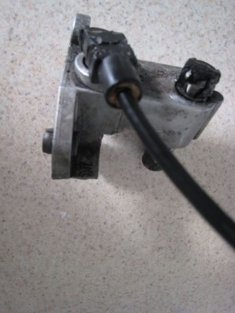

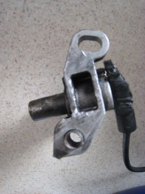

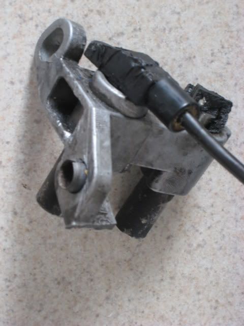

well hello again today everyone i have some good and bad news, first lets start with the good news :D i was able to get the bracket out like i said in my post from yesterday I went wiggle it with my hand and out it came i guess the beating from yesterday showed the car i meant business it's insane the amount of trouble i went with this thing anyways here's the bad i broke the the bracket where he timing mark sender goes i guess from all the force from yesterday it cracked there. I haven't bother taking the sensors off yet I'm gonna take some pics and post them up in a few. I still cant believe it came right out.
thanks for the link John_AZ i guess i'll be ordering me a new one, oh and the "sleeve" came out with the bracket.

h8tr_ 02-20-2009 02:25 PM
here are the pics:cool:
http://i25.photobucket.com/albums/c7...x/IMG_1544.jpg
http://i25.photobucket.com/albums/c7...x/IMG_1545.jpg
http://i25.photobucket.com/albums/c7...x/IMG_1548.jpg
http://i25.photobucket.com/albums/c7...x/IMG_1549.jpg
http://i25.photobucket.com/albums/c7...x/IMG_1552.jpghttp://i25.photobucket.com/albums/c7...x/IMG_1553.jpg
http://i25.photobucket.com/albums/c7...x/IMG_1555.jpg
http://i25.photobucket.com/albums/c7...x/IMG_1556.jpg

944_science 02-20-2009 08:24 PM
It must have felt good to get that out! Nice work, I take it it's unlikely I'm going to get the bracket out then without breaking it?
h8tr_ 02-21-2009 07:33 AM
well dude mines came out out of pure luck, if you could get the sleeve to move a little out then you could just put some pressure on it and it'll come right out then you could just pull out the bracket.
944_science 02-21-2009 08:32 AM
OK, by sleeve you're referring to the bolt sleeve to the right of the reference sensor? This is what stops the bracket from lifting straight up correct. It looks like it might pinch closed enough to slide it out, I guess I will give it a try.
alantica 02-21-2009 10:18 AM
Sensor Pics!
:cool: Great work! I know you wanted to call 911 for the fingers and a "hitman" to those sensors. Wonderful pics & notes for others to reference when they have to battle their sensors. Congratulations, let us know when you get her to roll! SmileWavy
