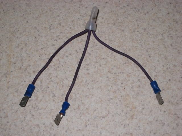

Hello everyone, I have some great news she fired up again turns out the DME relay was at fault, now i think back and maybe i didn't need to replace the sensors just yet but then again in the condition they were in i was gonna have to go through hell so better now then later i suppose, so i went to the hardware store today spent about .80 cents in supplies and made my dme relay jumper and plugged it in just like the instructions said on clarks oh and i also repositioned the sensors very carefully to make sure everything was good down there, after the jumper was in i heard the gas pump start up i said to myself well thats a good sign, then i got in the car closed my eyes took a deep breath and turned the key staring at the tach i saw it bouncing then i heard brrrrooooooommmm, so now my issue is that i need to replace the spark plug wires they are in really bad shape and the last one on the engine is not working as i kinda broke it trying to remove it, it was kinda seized in the hole anyways is there somewhere i can buy these for cheap i was not expecting for them to be so expensive but then again that should be expected on this car

h8tr_ 03-04-2009 12:35 PM
here is a pic of the jumper that saved the day!!!
http://i25.photobucket.com/albums/c7...x/IMG_1562.jpg

Thanks for the link John_AZ, I'm guessing the cap and rotor are the stock ones to so I'll see if i wait a little and replace everything all together, I'm doing the brakes on the TT and thats leaving me kinda dry for now, the good thing is my birthday is in 2 weeks so I'll try to get as much as i can for the Porsche and my birthday list. The big 22 is coming!!!!!! lol
