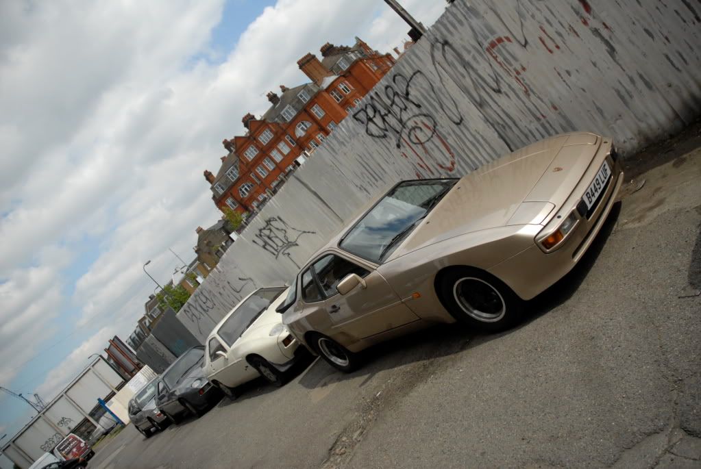

Hi all - new member here from, you guessed it, London. Pic of my Porsche below by way of introduction, and very well it's done me too for the last two and a half years. I did have one issue you might be able to help me with.

Welcome on Pelican Londonlux ,as you can see hold bunch of very helpful peoples here,is your car Platinum Metz if so I had an 83 same color if you click on my garage you'll see old faithful, could you send use more pics if you got some.

Same colour as your old car - for some reason I think it's Sahara Beige (best name for gold I've ever heard). Interesting mods on yours, but you Americans really do lose out on licence plate location don't you!

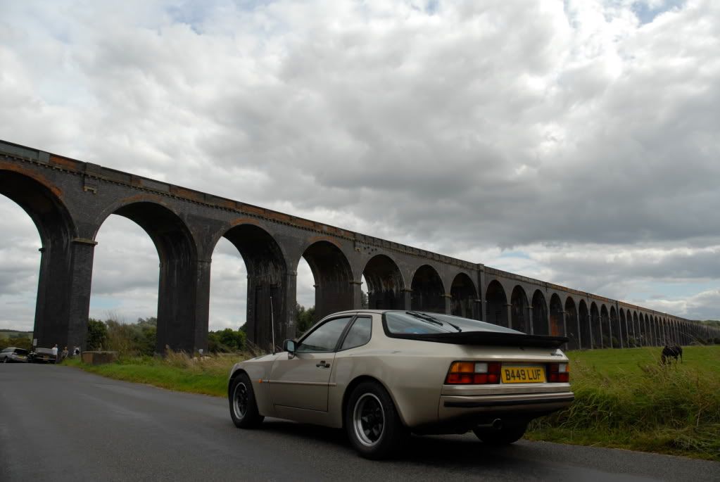

Another pic of mine - taken outside my local 'under the arches' Porsche specialist in Vauxhall, London

Or you could just be a rebel and skip the front plate
Welcome to the board! I'll have to give this fix a go in the spring.
Nice looking car!
