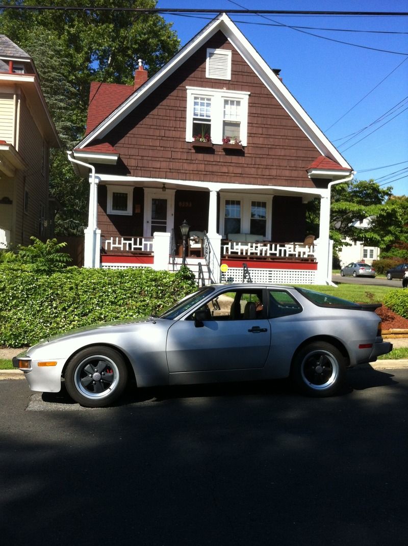

After 20 years of VW ownership, along with a spattering of Mercedes, as well as my current daily driver, I am finally in a Porsche. That being said, and given this forum's stellar reputation, I'm looking forward to becoming a trusted member. Below are a few photos. It's in great shape, though nonetheless, like any 30+ year old car owned by an enthusiast, it will require updating. I got PA antique tags...knowing that I'll never have to get it inspected or re-registered is liberating to say the least. I'm sure to have updates/questions...Please contribute if you'd like.
What needs attention:
very slight oil leak; no drip spots. Hoping that the gaskets will expand after regular running and driving.
window, sunroof, hatch seals need attention
fog light out
cooling fans aren't coming on done
no air, hot or cold, coming from the vents
steering wheel stitching mostly gone
outer shift boot falling apart
refinish wheel centers done
clean-up dash cover install done
lower rear, via bolts done
dim console lights
ping sound from driver's door when turning hard to the right
haven't tried turning on the a/c...scared. Would deleting it take away from it's relative factory condition?
sidewalls on 2 tires are cracked, but otherwise in decent cond.
speaker grills needed
hatch struts
rear, right running-light bulb out

Looks like a really nice example!! Any special options other than the Fuchs? Do you know any history on the car or did you get any paperwork with the car?
