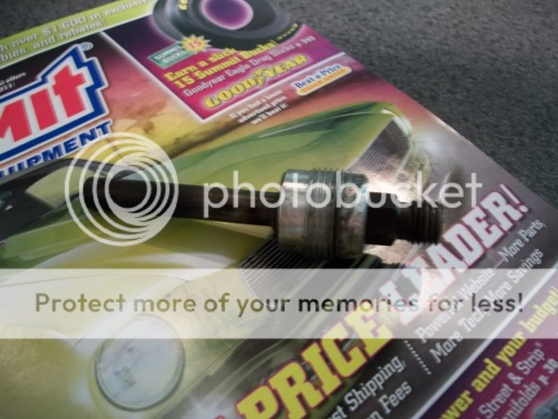

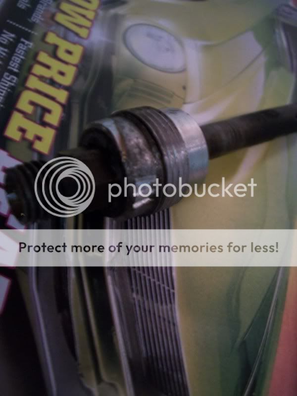

iam in the process of changing my injectors and i cant remove the injector from the thingy the injectors screw into. any ideas? i tried PB blaster, clamping and torquing but it didnt work. any ideas? should i just buy new ones? whats the part number?

The Aluminum Collar pushes up towards the Injector Threads. It's the old dried up seal that is holding it down.

wow, haha. thanks! mine are pretty beat up, do you know where i can get some new ones with the seals and everything?

I got mine from 928 Intl (get new), but I am sure Pelican has them too.

do you know what seals i need for the sleeves??

You really need to download PET. Great stuff with Diagrams and Part Numbers
928 110 398 00 For the Seal
928 110 399 02 For the Collar
