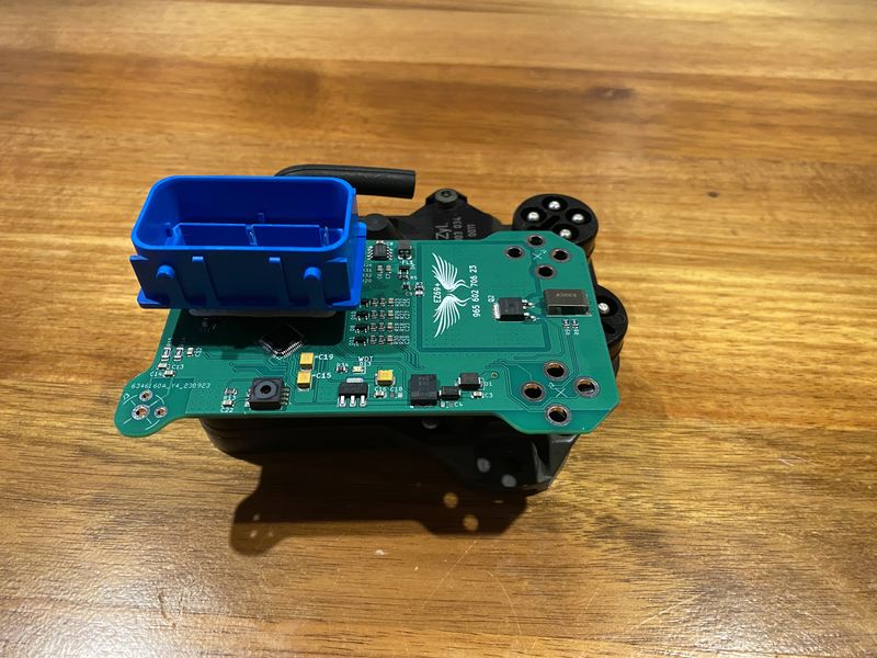

Fourth revision has been approved and sent to fabrication.

Remember anyone saying "math might save your life" ?
I guarantee it wasn't an engineer.
defining accurate pin placement for the connectors involves this :-

The EZL is still under development, but the primary requirements in order of importance are :-
  1. Plug and play - no wiring changes
  2. Looks OEM
  3. Ignition tuning

Shall do,
The Hardware is running on the bench and the firmware core is functionally complete.
The design and implementation is closely following OEM features and requirements with a few modern tweaks to enhance reliability and protection.
Case and connectors are not yet finalised. As we back-and-forth with suppliers, specs have been refined to match manufacturing realities.
So we are frequently deciding on little details, and then rinse-repeat.
Also, everyone, please hang on to your dead ones as we might also be able to do an exchange program for the EZ69 case.
The schedule has us well placed for in-house vehicle testing of two different prototypes by early April, so maybe mid-year for one or more hand-built units to escape the lab.
poor little naked one on my desk now
and our calibration software connected
