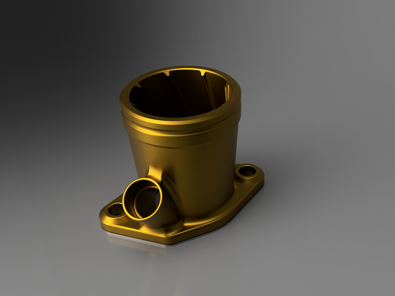

Here are the ITB adapters I designed years ago that were physically machined in China from a fellow member.
Looks like you have the same interface:
Cory - turbo'd '87 C3.2 Guards/Blk, 3.4, 7.5:1 CR, 993SS cams, Borg-Warner S366 turbo @ 1.2-1.5 bar, Treadstone full bay IC, 70mm TB, TiAL F46 WG, HKS 1 1/2" BOV, twin 044 pumps, MicroSquirt AMP'd w/GM smart coilpack, Bilstein coilovers, Tramont replica Speedlines (285's rr, 225's frt), Big Reds frt, 993 rr., tower brace, MOMO wheel

Nice! I reverse engineered mine from a 3D scan of the stock manifold. The injector angle was a tricky part.
A bit of an update. I decided I should do a test torque of the runners before gluing everything together. The result, total failure. Crapola...
I torqued them early on but this time I used the proper plastic intake spacers. I think what happens is that the intake spacer is soft and deforms under the 3,000 lbs of clamping force for each of the mounting bolts. The compliance of the spacer transfers a huge amount of load across the full face rather than just below the bolts. The plastic flange has basically zero flex so it cracks.
The plastic flange would work on a metal surface but it's not going to work on the soft plastic spacer.
So...the plan is to have the lower sections 3D printed from Aluminum and then bond them to the nylon intake. It's an extra $350 and a little annoying.
Yes, the injector angle ate my lunch. I was just learning CAD, so it took me weeks of messing around before it was right and mimicked the Carrera 3.2 perfectly.
This is a super cool project!
I hit the same point when doing my 3.0 EFI conversion, the plastic adapters just weren't up to it so had them 3D printed in aluminum. Pretty easy for my application since I was already using the 964 manifold and factory gaskets so I didn't have to make many design changes to just bolt on the new ones.
The amount of material does significantly impact the price though, so for mine I found I could get away with a much thinner flange overall with just adding more thickness at the bolt hole with a healthy chamfer for support.

Beautiful part. Love it. My adapters are much heavier weight unfortunately bc I designed them to be plastic. My CAD model is such a mess and Fusion 360 is quite weak in terms of parametric referencing. Changing the flanges (the first features in the model) isn't an option anymore!
