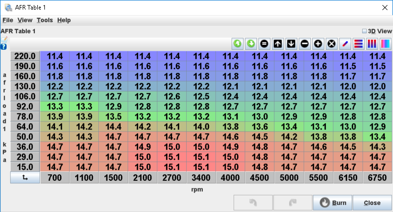

Thanks for the response. I am still trying to find my way around TunerStudio. I have been doing a lot of reading. I have not had an opportunity to do any further tuning. I am hoping to get around to it tomorrow night. I was having a minor issue with my VR sensor. I believe it was causing the intermittent stumbling.
Car idles very well, steady at 14.7 AFR, even as temperatures climb. It's only when I have to restart that I have a problem. I will try to implement the procedures you have outlined.
Perhaps once I get more tuning completed you could have a look at my tune to see if there is anything glaring?
Thanks Again
John

Here are some of my settings. If you experienced MS guys could have a look and comment, if something looks off, I would really appreciate it. It may help the next guy.

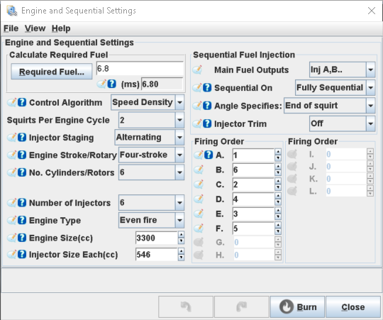

General Settings

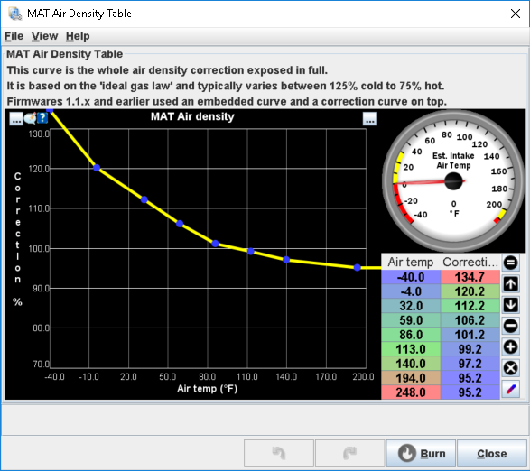

Mat Air Density Table

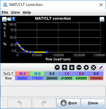

MAT/CLT Correction

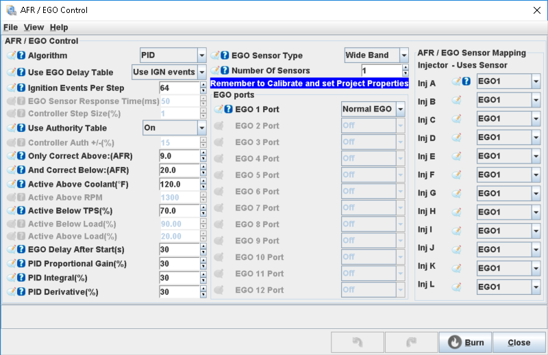

AFR/EGO CONTROL

AFR Table 1

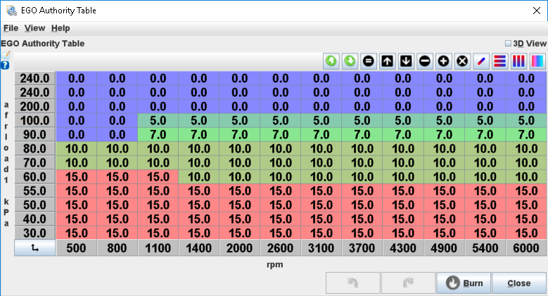

Ego Authority

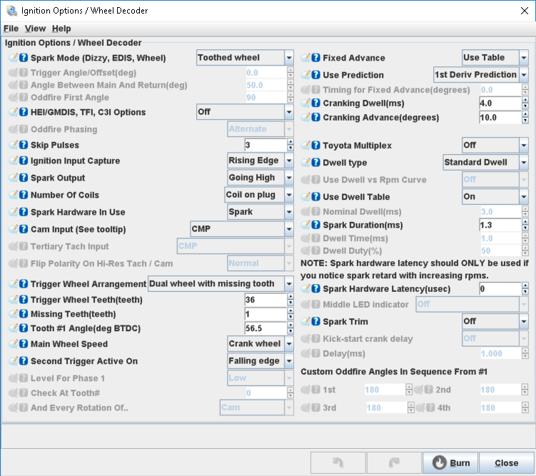

Ignition Options\Wheel Decoder

I see you don't have a specific toothed wheel selected? Are you 60-2 or 36-1?
AFR's around idle and low RPM up to say, 2500, IMO, should be mid-13's*. This will aid lean tip-in and make the engine run smoother.
*You're sequential, so yours will run better than batch at stoch, but using ITB's and speed density is going to make lean tip-in a PITA to get right.
