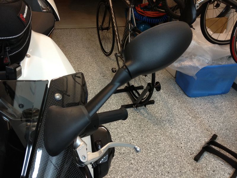

HP2 Sport Mirror Bracket update.

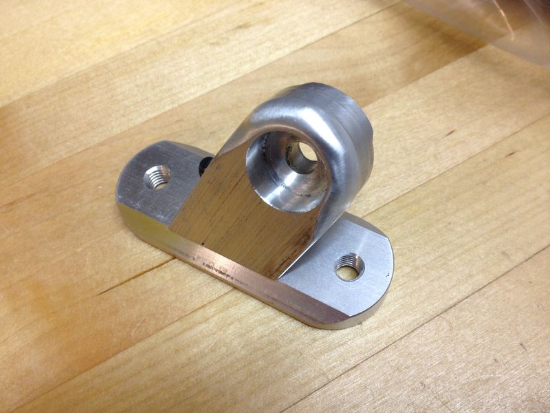

Ok here is the promised update on the HP2 Sport/ S1000 Mirror mounts. I worked on this through the week trying to get it into aluminum from the plastic quick prototype piece that has evolved over the last few months. Didn’t have too many paying jobs, so this got more attention.

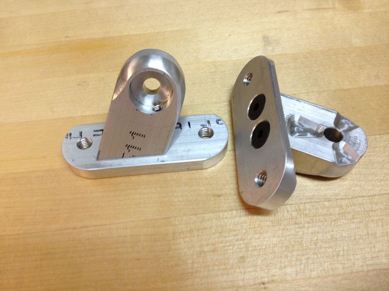

On the plastic piece the indents for the breakaway connection needed more attention. They worked but not as well as the stock S1000 ones did. Spent a lot of time hand machining and then transferring that to the CNC and now have them perfect.
The other bigger problem was due to the complex shape and angles the CNC could not get into the area where the upper arm meets the base. After 2 different aluminum tries, it came out with the correct dimensions but looked like a blob of metal. Might not matter much as it under the rubber cover but it sent me back to the drawing board literraly.

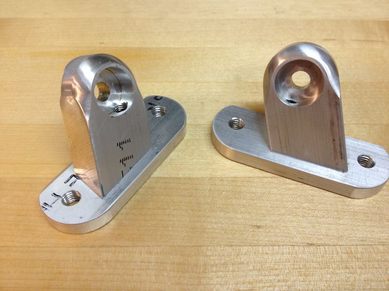

I decided to make it out of 2 pieces. The base and the upright and then screw and epoxy them together. This meant another complete drawing and program and was a little complicated to get the holes in the correct location through 2 pieces with the angles. What resulted was the mount that you see here. It works, and doesn’t look bad.
There is still one more prototype to go. The screws will be hidden and in blind holes (I think) and I want to change the angle on the base piece or move the detents clockwise a few degrees to move the mirror arm forward. At the angle it is which is the same as the S1000 taller riders (me) could use more adjustment. Hopefully that will happen next week.
They are installed with the stock mirror screws. I weighed the mirrors and the new mirror is 50 grams less than the original, so less weight but more leverage.

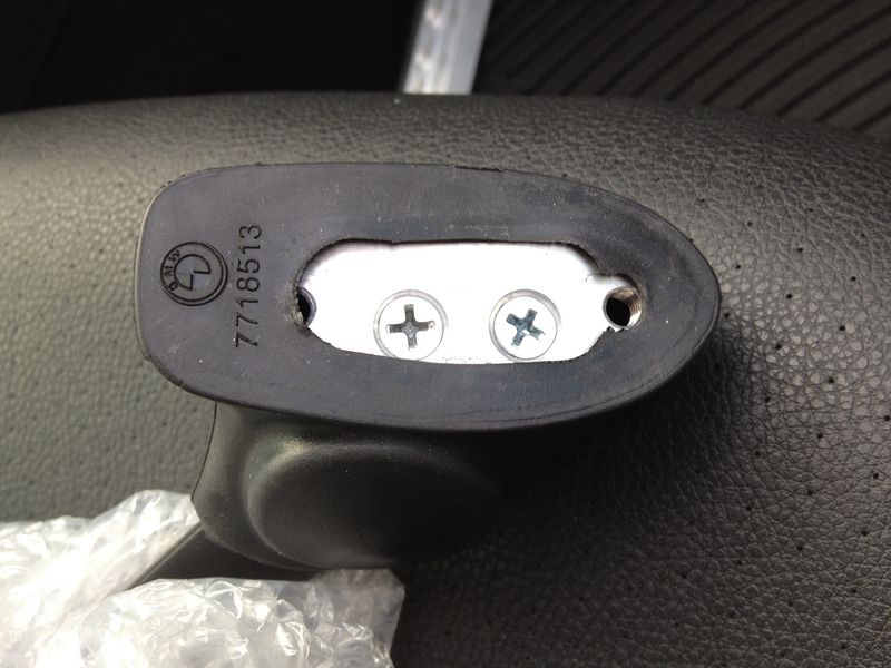

I'm in for a set. Just let us all know when to send the money and where to send it. Does there need to be a thin gasket in place between the mount plate and the carbon fiber shell. I think there needs to be something in place there so that when the mirrors are not mounted, there will be no worn marks in the carbon fiber top gel coat which would then be full exposed. Curious.
Old 05-21-2012, 06:40 AM
Join Date: Jun 2011
Posts: 69
HP2 Sport mirror
Actually the rubber boot from the S1000 mirror goes around the base and is the gasket for the base, and the shape of it covers the outline from the stock mirrors the way it is positioned. It was actually one of the design elements. Thanks to all for your interests. As soon as I have the final parts and have ridden them, I will figure out the price and let you know.

I Know everyone is thinking that these things are vaporware, but the mills have been running 12 hours a day making aerospace stuff that pays the rent. Had a break this week and cranked out three more versions with slight modifications. It seems easy to just copy the original ones and change the mounting hole location. This is a pretty wierd shaped piece and in reality is not that simple.
The part that was the most challenging was the "clocking" of the indents so that there was enough adjustment in the mirror for different height riders. So I am happy with it all now, and have sent a set of prototypes to another Pelican for input. I am riding the latest set Sunday, and expect that they will be fine. All the tooling is complete as is the programming. Simplified the design so the bases are interchangeable. There are no manual steps at this point except assembly.

So in the last 2 weeks or so I have been testing the mirrors and resolving the non standard hardware I had used in the previous prototypes. This resulted in some small adustments in the programming. I was attempting to make sure that most people could install these themselves without too much hassle. I have had these things apart so many times that I just assumed anyone else could do the same with some basic mechanical skills.
I contacted Droptrarotter and asked him if he would test a set for me. See if he could convert the mirrors and get them on his bike and to give me feedback. I sent him a set without too much instructions and DT reported to me that he was having some issues with the conversion. Now DT is a mechanical genius (which I didn't know at the time) We went back and forth with emails, I made a video and sent it to him and tried to replicate what he was experiencing.
Turns out that the problem was with the screws and type of nuts I chose. When pivoting the mirror repeatedly the locknut would loosen some. This was not in its normal usage but needed to be corrected. Changed the locknut from a nylock to a stover and changed one flat washer to a larger one, and changed the base screws to stainless. It also does take a little more than average mechanical skill to convert these.
DT will do a write-up later as he has left on a bicycle tour. Thanks DT for the feedback so I could get them perfected.
So tomorrow the 1st production run of 10 sets will begin and should be completed early next week.
I have recieved a several PM's from interested parties. I have negotiated a deal with the local dealer to get a discount on the S1000 mirrors if don't already have them. I will offer the mirrors already converted, so you can just bolt them on or just the brackets if you want to do it yourself. I am still settling on the pricing but it will be reasonable.
